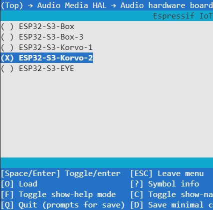

Re: i2c: This driver is an old driver, please migrate your application code to adapt `driver/i2c_master.h`
I think I maybe able to give back this time.
I had the same problem but I found that if I go into menuconfig and make a change to Audio Media HAL and go into Audio hardware board and change it to the correct board (ESP32-S3-Korvo-2 in my case) that driver error goes away.
So it's:
idf.py menuconfig
then:
Audio Media HAL->Audio hardware board-->ESP32-S3-Korvo-2 (or select your board)
esc + save (y)
and then:
idf.py build
Hope this helps.
