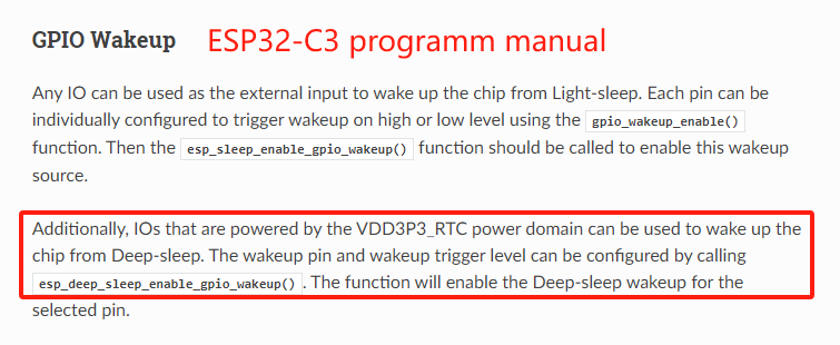

I have a question about the GPIO wake up in the ESP32-C6 chip.
I used to have a ESP32-C3, which uses esp_deep_sleep_enable_gpio_wakeup() to enable certain GPIOs to wake up deep sleep.
But after checking the ESP32-C6 manual, I found that GPIOs can only wake up light sleep. Is esp_deep_sleep_enable_gpio_wakeup() removed in C6?
ESP32-C6 sleep manual:
https://docs.espressif.com/projects/esp ... modes.html
ESP32-C3 sleep manual:
Could anyone confirm this? Any suggestion would be greatly appreciated.
C6 manual.png (72.91 KiB) Viewed 15202 times
C3 manual.png (39.45 KiB) Viewed 15202 times

Not the answer you might be looking for, but I'm using esp_sleep_enable_ext1_wakeup() and that works fine on the C6.

Thanks but I still want to use GPIO to wake up DeepSleep.
I noticed that External Wakeup can be used to wake DeepSleep with RTC GPIO, but I didn't find any description on the web about which pin of the ESP32 C6 can be multiplexed as RTC GPIO.
Can you make a suggestion?
The code reference only describe the API, but not mentioned about physical pins:
https://docs.espressif.com/projects/esp ... /gpio.html
Posts: 10636
Re: Can ESP32-C6 use GPIO to wake up Deep Sleep?
Postby Sprite » Fri Mar 22, 2024 11:46 am
See the datasheet, section 2.3.2. Long story short: GPIO0 to GPIO7 are RTC (LP) GPIOs.
