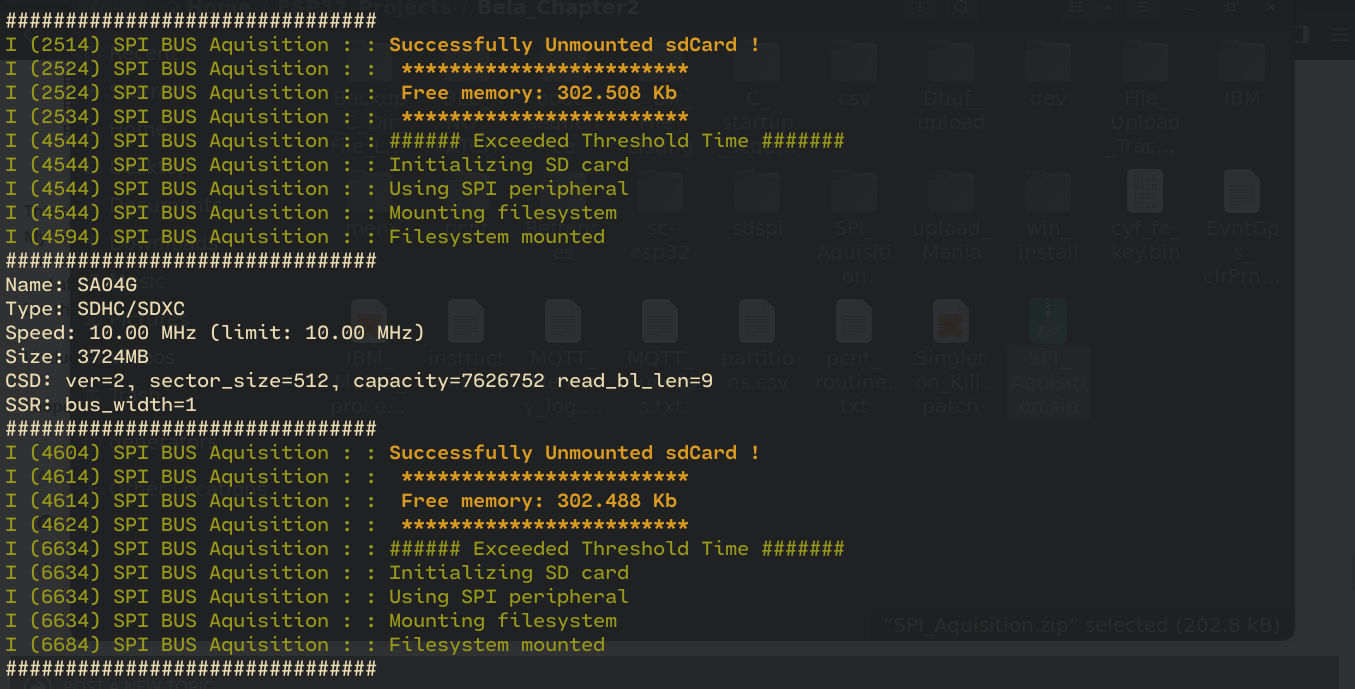

In brief words
- We have to mount and un-mount sdCard on regular basis
- First time we do this -> no leak
- 2nd time mounting doesn't leak memory either
- 2nd un-mount of the sdCard leaks memory
Chip : ESP32 (rev 1)
IDF : ESP-IDF v5.1.3-416-gd23b7a0361
Reproduce Code

if (esp_vfs_fat_sdcard_unmount(mount_point, card) == ESP_OK)
ESP_LOGI(TAG, "\033[1;33mSuccessfully Unmounted sdCard !\033[0m");
return 0;
void Task_TakeOver_SPI_BUS(void* arrow)
for(;;)
ESP_LOGI(TAG, "###### Exceeded Threshold Time #######");
Init_SPI_BUS();
// List_Files_ON_Flash();
Free_SPI_BUS();
heap_caps_check_integrity_all(true);
ESP_LOGI(TAG,"\033[1;33m ************************\033[0m");
ESP_LOGI(TAG,"\033[1;33m Free memory: %0.3f Kb\033[0m ", esp_get_free_heap_size()/1000.0);
vTaskDelay( 2000 / portTICK_PERIOD_MS);

Memory log from MQTT (from the original project)
Chip Started
Wifi Started
Getting Auth Info , Memory : 161Kb
Getting Auth Info ..... Success !, Memory : 171Kb
Free Memory at ALL_FILES_UPLOADED , Memory : 175.068 bytes
Free Memory at ALL_FILES_UPLOADED , Memory : 175.056 bytes
Free Memory at ALL_FILES_UPLOADED , Memory : 175.040 bytes
Free Memory at ALL_FILES_UPLOADED , Memory : 175.024 bytes
Free Memory at ALL_FILES_UPLOADED , Memory : 175.008 bytes
Free Memory at ALL_FILES_UPLOADED , Memory : 174.992 bytes

This keeps happening till the memory is eroded
My Tests show that this only happens after the 2nd Un-mount of sdCard
I have traced the free memory after 1st Time Mount and then Release
and after the 2nd Time mount , and it typically deducted about 27k
but then after the 2nd Un-mount the above behavior happens
I included a Test project
SPI_Aquisition.zip
Test Project
(198.09 KiB) Downloaded 158 times
I hope I'm doing something wrong here , cause we do need this to work

Hi @plusorc, Could you please try the same example on IDF v5.2? The issue you are facing has already been addressed in this version.

Thank You so much for your help
Switching to v5.2.1 solved the problem
