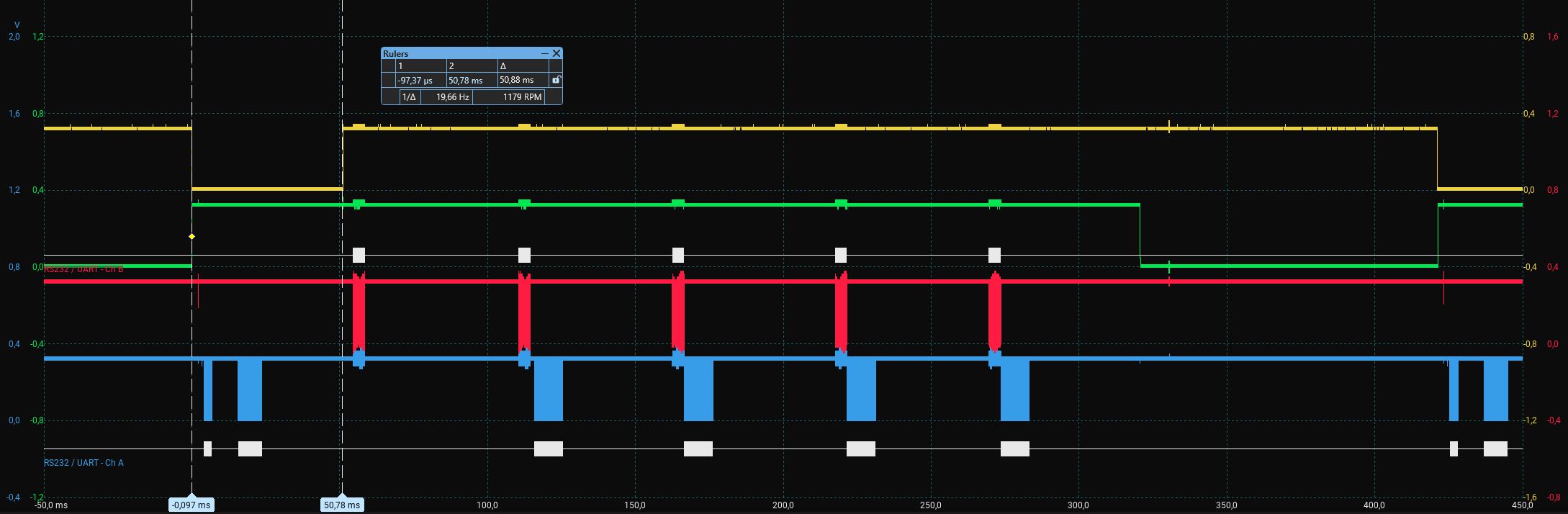

Strapping is working fine, for now I use RTS and CTS to enter the bootloader, the module replies: "ESP-ROM:esp32c3-api1-20210207...." which proves that the bootloader starts.
Flash program tool sends: C0 00 08 24 00 00 00 00 00 07 07 12 20, 32 times 55, C0
Module replies: C0 01 08 04 00 07 07 12 20 00 00 00 00 C0 01 08 04 00 ...
Sequence repeats over and over again.
I have attached a sreenshot: yellow = IO0, green = ENA, red = module RX, blue = module TX.
So why doesn't the Flash programmer accept the reply from the module?

Found the issue, it was in the code of the STM32: the data returned from the ESP module was not send back to the pc. Case closed.
