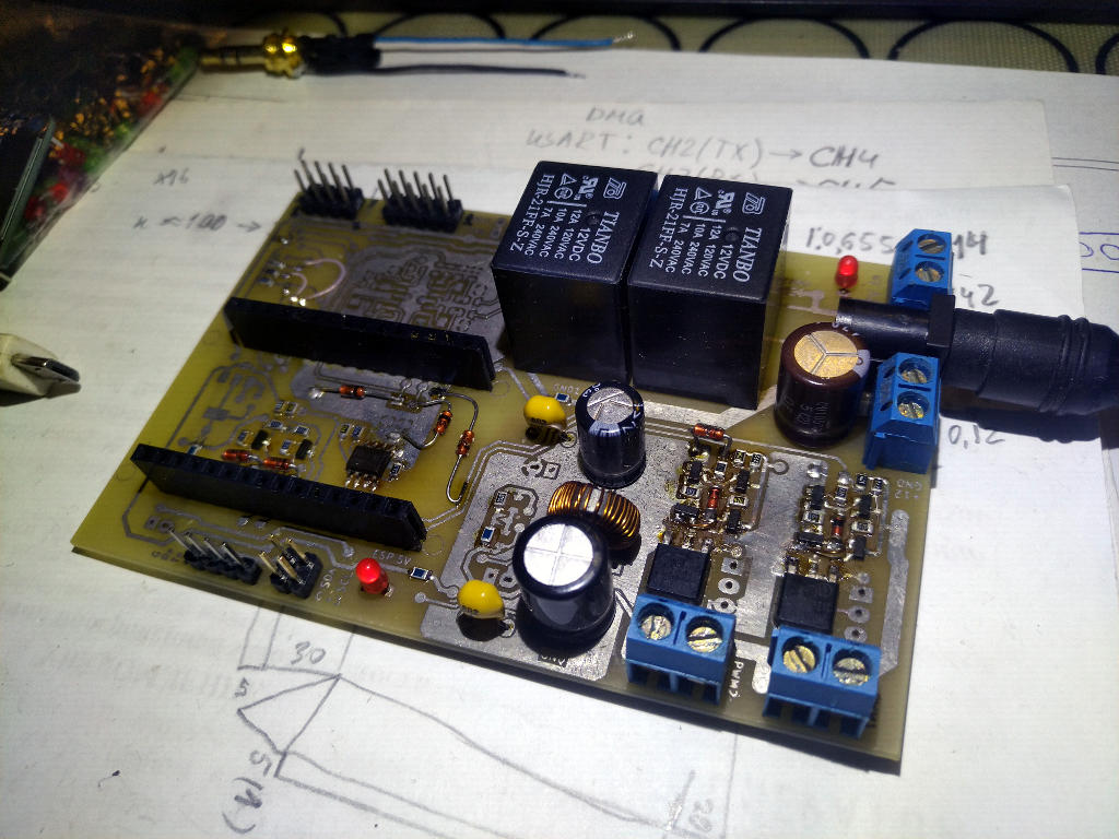

Extension of ESP32 DevKit V1:
  • External 12V power source
  • MC34063-based +5V and -4.2V regulator(both ~300mA max)
  • Place for LD1117-3.3, if necessary(DevKit V1 one used by default)
  • I2C connector at 3.3V
  • I2C EEPROM 24LCXX
  • 1 x 2x4 decoder/demultiplexer generating CS0..CS3 for SPI devices
  • 1 x 3.3V SPI connector with CS1..CS3
  • 1 x 3.3V SPI LCD connector with CS0 and background LED power
  • UART2 connector at TTL(5V) levels
  • 2x 7A SPDT relay(12V coil)
  • 2x 20A 30V N-MOS with 12V BJT gate driver
  • 2x ADC OP-AMP input buffer
  • 2x DAC OP-AMP output buffer

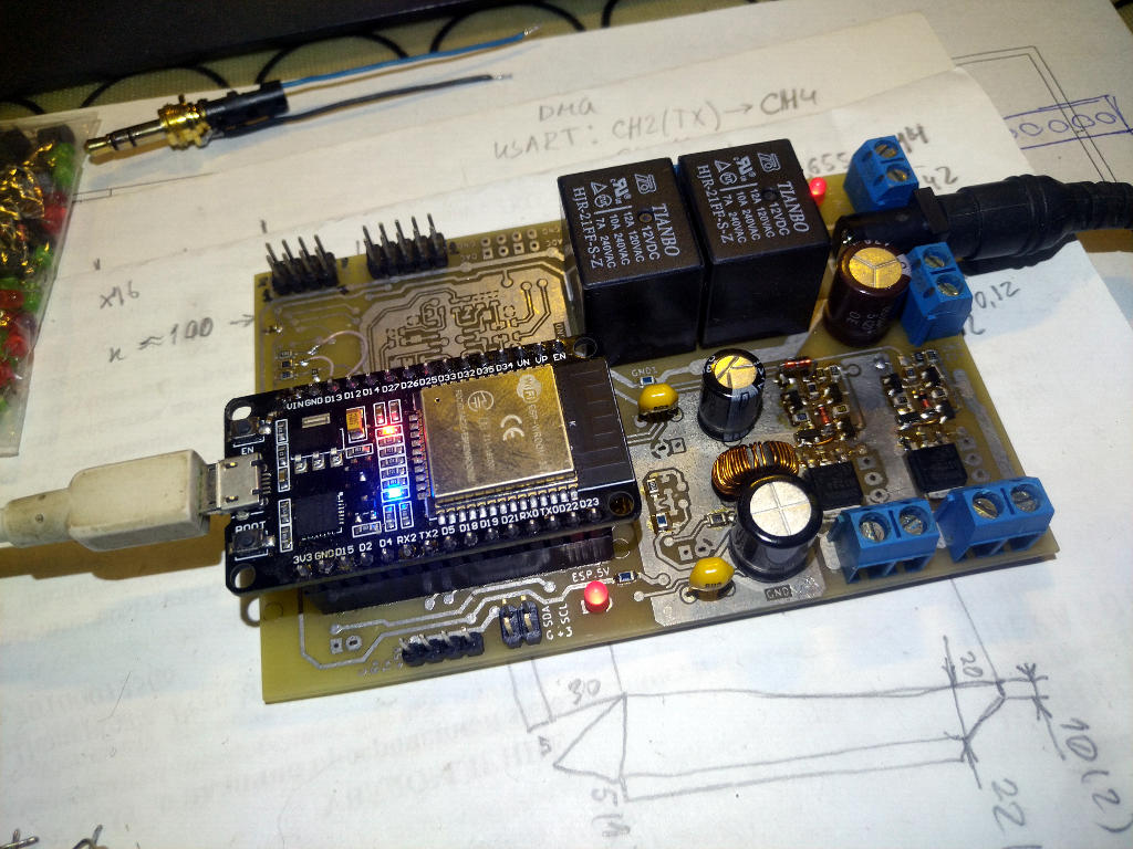

Hi, How can we access all the GPIO pins of the ESP32 when using this board?
powerbroker
Posts: 35
Joined: Sun May 19, 2024 12:58 pm
Re: ESP32 DevKit V1 Extension board
Postby powerbroker » Sat May 25, 2024 2:24 am
by extracting Devkit V1 out of it ;)
allmost each GPIO pin of Devkit V1 has assigned function on the board, except SENS_VP/SENS_VN(which are not wired) and GPIO1/GPIO3, which are Rx0/Tx0 of Devkit V1 on-board USB com port.
