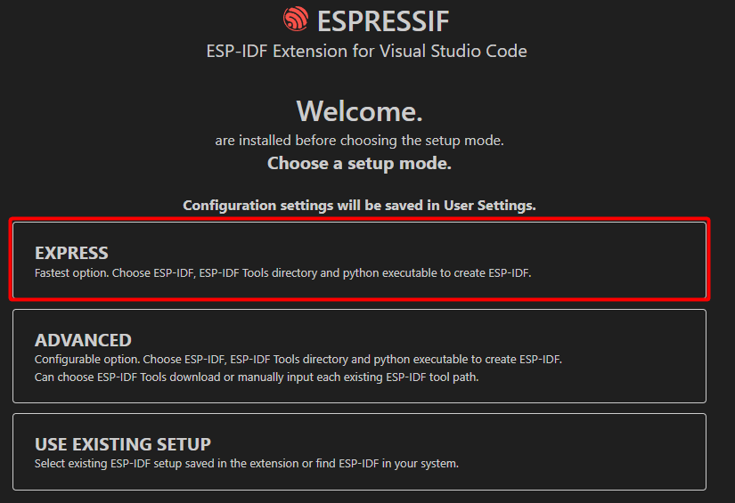

1. Install VSCode and ESP-IDF Extension
2. write "ESP-IDF: Configure ESP-IDF extension" in command palette and click
3. click "EXPRESS"

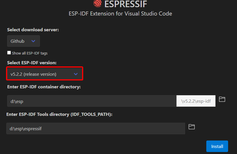

4. Select ESP-IDF v5.2.2 and install

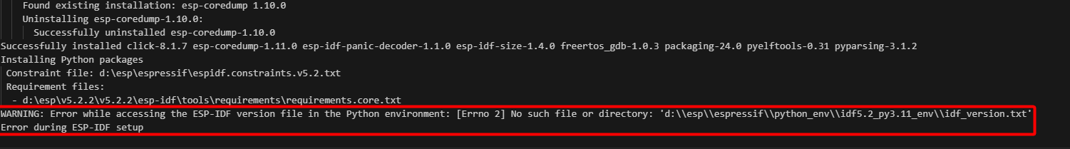

When complete install, face error message.
setup error message.png (24.53 KiB) Viewed 9674 times
When creating an example in VSCode("ESP-IDF:Show Example Project" in the command palette), the ESP-IDF version v5.2.2 is not activated, and when checking the USE EXISTING SETUP item in "ESP-IDF: Configure ESP-IDF extension", v5.2.2 does not appear.
How can I complete setup?

I found below in log file you mentioned:
Error: Command failed: \"d:\\esp\\espressif\\tools\\idf-python\\3.11.2\\python.exe\" \"d:\\esp\\v5.2.2\\esp-idf\\tools\\idf_tools.py\" install-python-env\nERROR: Python environment is set to d:\\esp\\espressif\\python_env\\idf5.2_py3.11_env which was generated for ESP-IDF v5.2.2 instead of the current 5.2. The issue can be solved by (1) removing the directory and re-running the install script, or (2) unsetting the IDF_PYTHON_ENV_PATH environment variable, or (3) re-runing the install script from a clean shell where an ESP-IDF environment is not active.

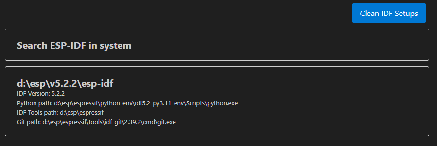

I tried the first method suggested in the log, and the installation appears to have completed normally in VSCode.
esp-idf_v5.2.2 settup.png (13.48 KiB) Viewed 9442 times
It has been resolved, but I think the same problem appears to occur even if v5.2.2 is additionally installed in an environment where the v5.2 version is installed.
