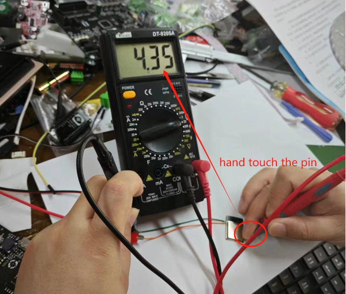

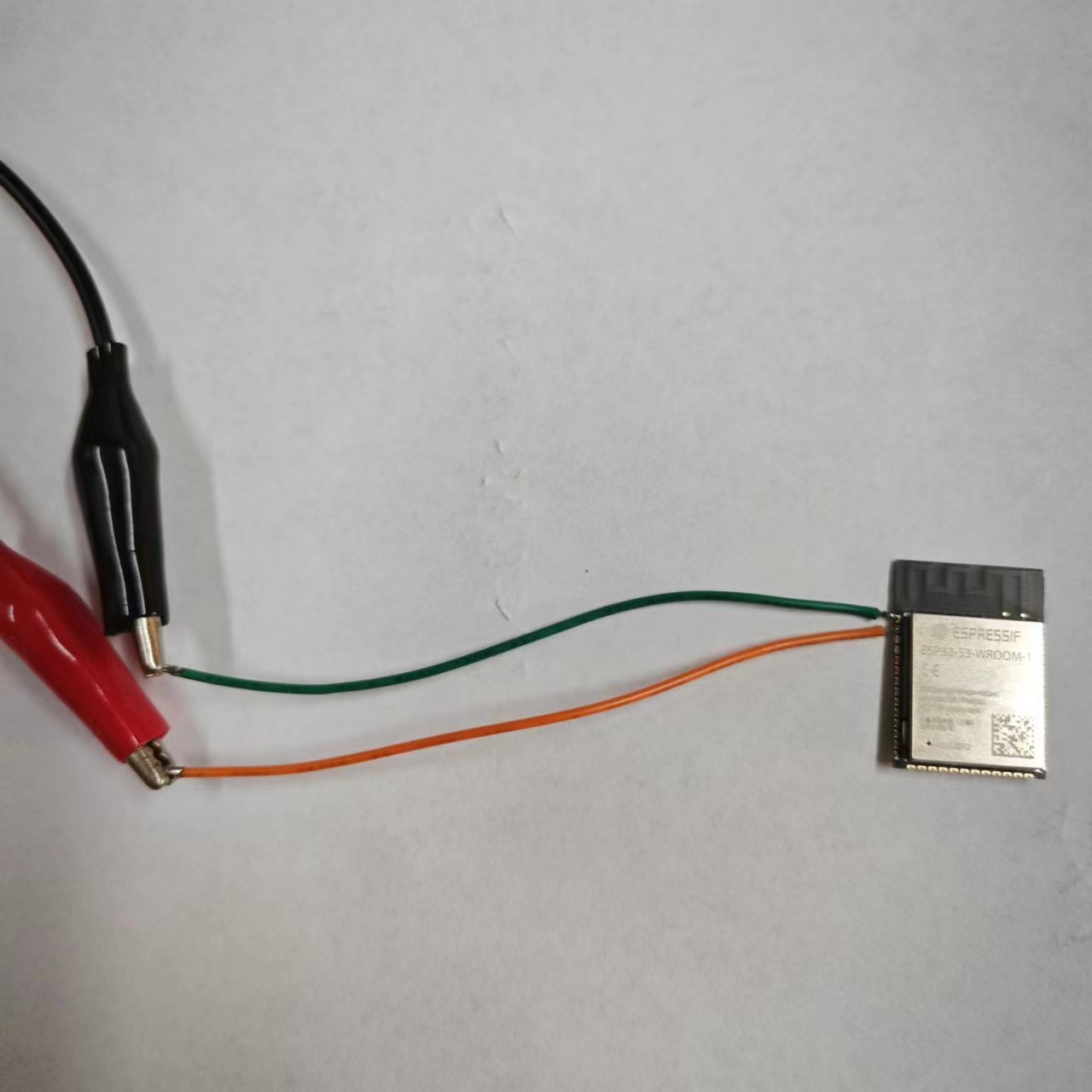

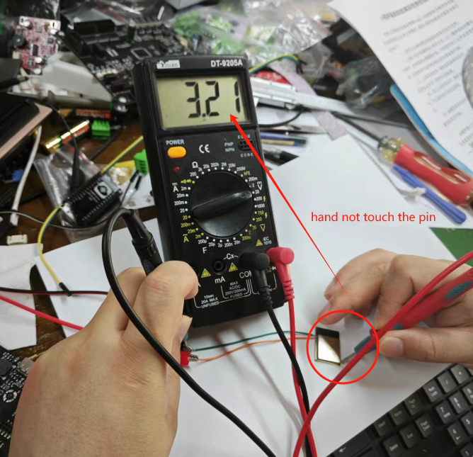

At first, I didn't believe it, and I also suspected that there was a problem with the measurement. However, before I suspected it, many modules of my ESP32-S3 were already broken. After pulling up, the voltage level was only about 2V, and the code was judged to be low. It was because the pins were already broken that I started measuring them with a voltmeter, which revealed the problem. Moreover, this phenomenon has been found on ESP32-S3-WROOM-1, but not on ESP32-C3 module.

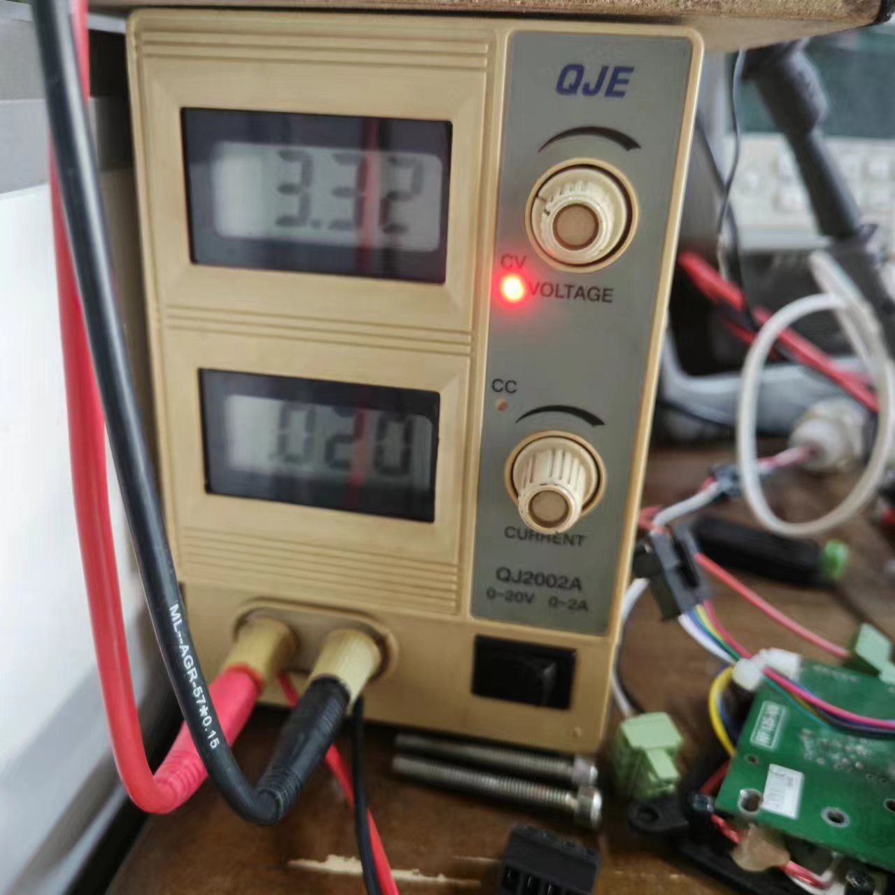

It's very simple now. I don't have any other peripheral circuits, only the EN pin pulls up 3.3V, and the external power supply 3.3V. After powering on, touching the pin with my hand will cause problems with voltages higher than 3.9V.
I have replaced the power supply and the voltmeter, but the measurement results are the same.
