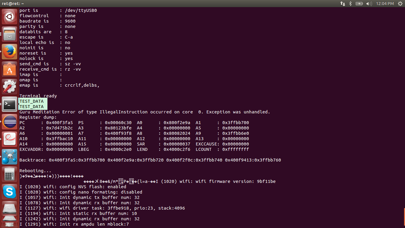

Hi i am working on ESP32
while using uart-1 receive interrupt and WiFi together in ESP32 , module is resetting after receiving data 3-4 times, the same functionality is working fine with uart-2 , can anyone suggest solution to fix this issue.
here i am attaching the code what i am using please find the attachment below.

Pin 9 and 10 are used for the SPI flash as well; putting an UART there interferes with reading code from that flash, making everything crash. Use different GPIOs and you should be fine.

I couldn't find any alternative pins for uart1, in datasheet they given only pin 9&10.
I am getting this issue only when WiFi init is called, without that i am not getting this resetting problem.
Could you please check that also,
Now we are in a situation that we cant change the pins of uart1, Is there any alternative without changing the pins to solve this issue.

Erm, what do you think the uart_set_pin function is for? You can essentially set the UART pins to any ESP32 pins that way (given they match the characteristics you need, that is, you can't set TxD to a non-output GPIO).
As you have it now, you're essentially pulling up and down the write protect and hold lines of your flash during UART transmissions. As far as I know, there's no simple workaround for that crashing the system eventually.
