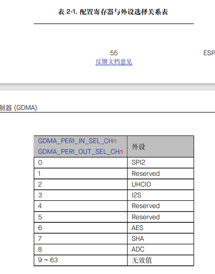

It has afterimage when I using ESP32C3`IIC to drive ssd1306 with 1 MHz. So I want to solve this problen with DMA. But in Technical Manuals, I can`t find IIC config in DMA, like this:
屏幕截图 2024-08-17 170549.png (33.94 KiB) Viewed 4423 times

No, I2C doesn't support DMA. Note that this generally also is not needed as the I2C protocol itself is not really that fast. If your display supports it, you can try using SPI; that can go faster and does support DMA.

Thank you. I will look for a better displayer.

If I can use DMA, my transmission will be faster than now.
No, it would not.
I'm not sure what the problem is you're seeing, but it may be more of a timing issue, i.e. synchronization with the display's refresh cycle.
How many pixels at what framerate do you want to draw?
