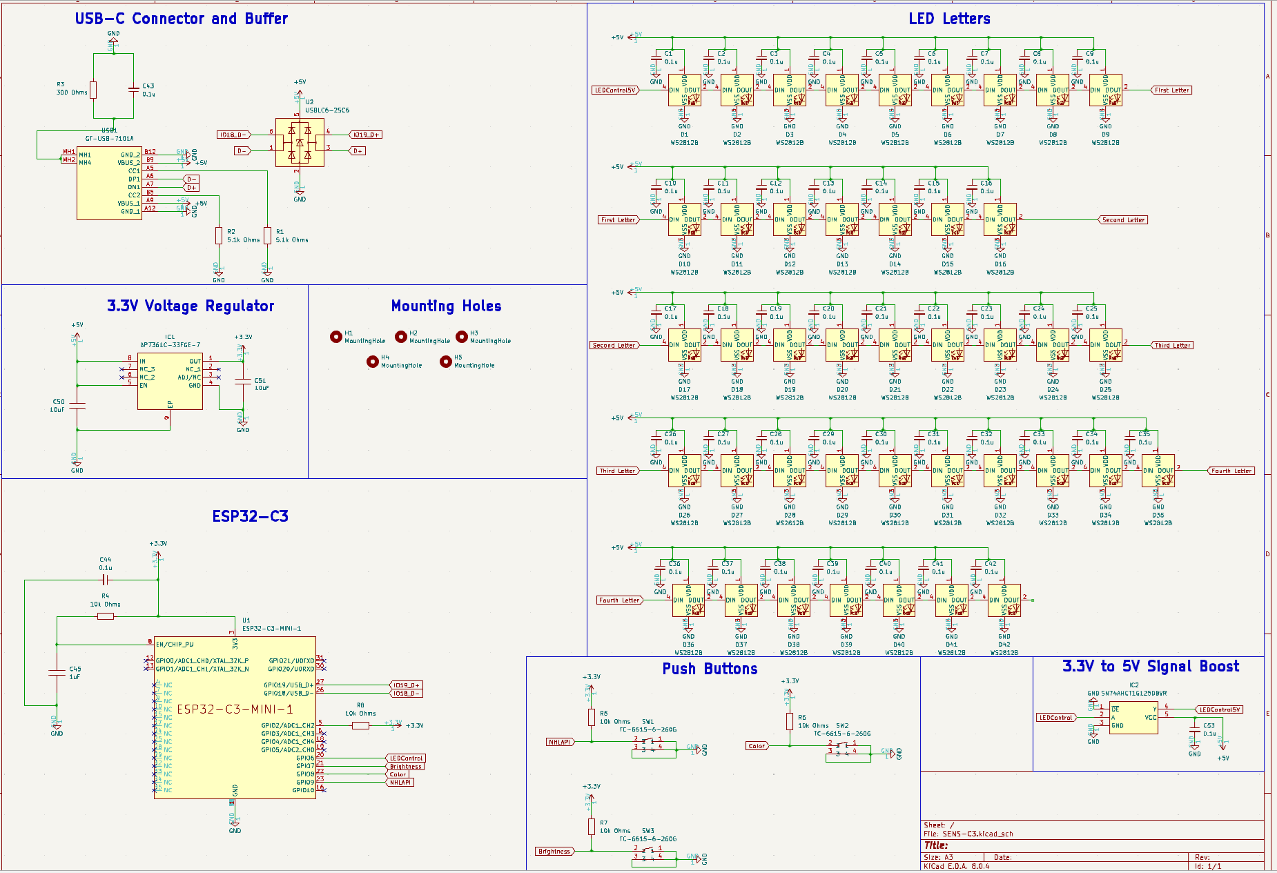

I've finally had some time to try to work on my custom designed (and externally verified by several people) ESP32-C3-Mini-1 as shown below as Circuit Layout. However when I try to hook it up to my Windows 11 machine that has no issues communicating with ESP32 devboards I end up with the following USB error shown below as USB Fail, and I can't seem to figure out how to get it to recognize it as as far as I am aware there are no USB drivers if it is connected via its built in USB JTAG. Additionally there 'shouldn't be any drivers for the USBLC6-25C6 as all it suppose to be is a buffer chip to protect the ESP32-C3-Mini-1's USB ports.
I am hoping it is something very silly/stupid like I am not booting into the correct mode of Joint Download Boot, but I have tried to boot up the system holding down the button that would pull GPIO09 low without any differences.

Can you try if it's detected properly when you hold SW1 while plugging in the USB-cable?

After having posted this I noticed the d+ and d- connections are wrong from the usb-c connector. I modified a USB cable to swap those lines and it works with windows now.
