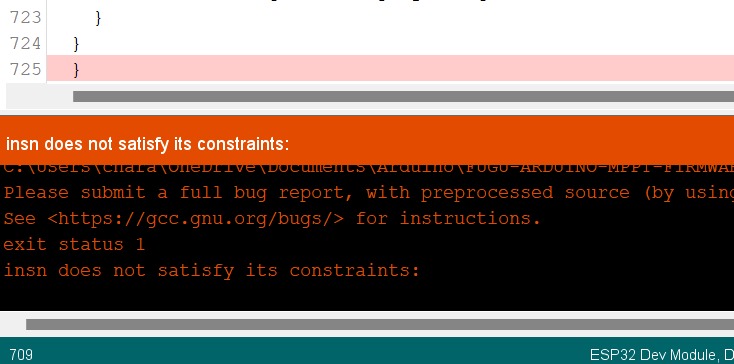

hii i am getting this error while compiling can anyone can help me...

Error:
Code: Untitled.c Select all
...8_LCD_Menu:377:1: error: insn does not satisfy its constraints:
377 | }
(insn 11 2651 1185 127 (set (reg:SF 19 f0 [orig:127 _95 ] [127])
(mem/u/c:SF (symbol_ref/u:SI ("*.LC357") [flags 0x2]) [0 S4 A32])) "C:\Users\chara\Downloads\CODE_MPPT_ESP32_V1.2.1-20240819T055256Z-001\CODE_MPPT_ESP32_V1.2.1\8_LCD_Menu.ino":205:33 49 {movsf_internal}
(expr_list:REG_EQUAL (const_double:SF 0.0 [0x0.0p+0])
(nil)))
during RTL pass: postreload
C:\Users\chara\Downloads\CODE_MPPT_ESP32_V1.2.1-20240819T055256Z-001\CODE_MPPT_ESP32_V1.2.1\8_LCD_Menu.ino:377:1: internal compiler error: in extract_constrain_insn, at recog.cc:2692
Please submit a full bug report, with preprocessed source (by using -freport-bug).
See <https://gcc.gnu.org/bugs/> for instructions.
exit status 1
insn does not satisfy its constraints: ...'''

Please post that in a separate topic.
