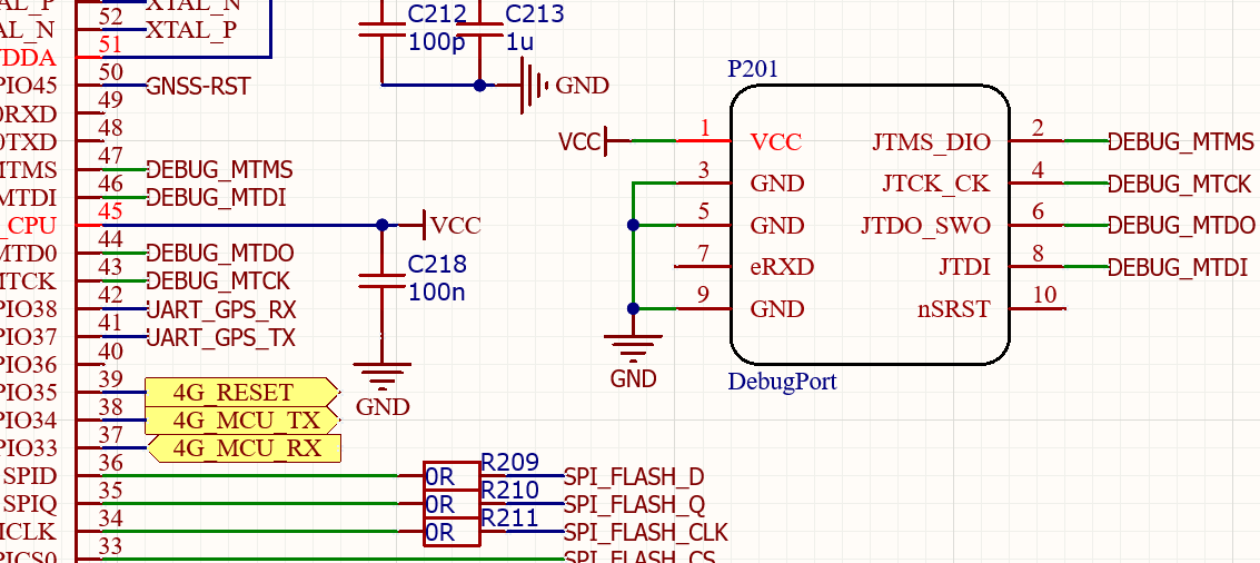

ESP32-S2 无法使用JTAG功能
Postby alphasion » Mon Sep 30, 2024 2:26 am
原理图如附件
PCB是照着这个画的,试过JLINK和ESP PROG都识别不到芯片,OpenOCD报错内容:

Error: JTAG scan chain interrogation failed: all zeroes
Error: esp32s2.cpu: IR capture error; saw 0x00 not 0x01
Warn : [esp32s2] Unexpected OCD_ID = 00000000
Warn : target esp32s2 examination failed
