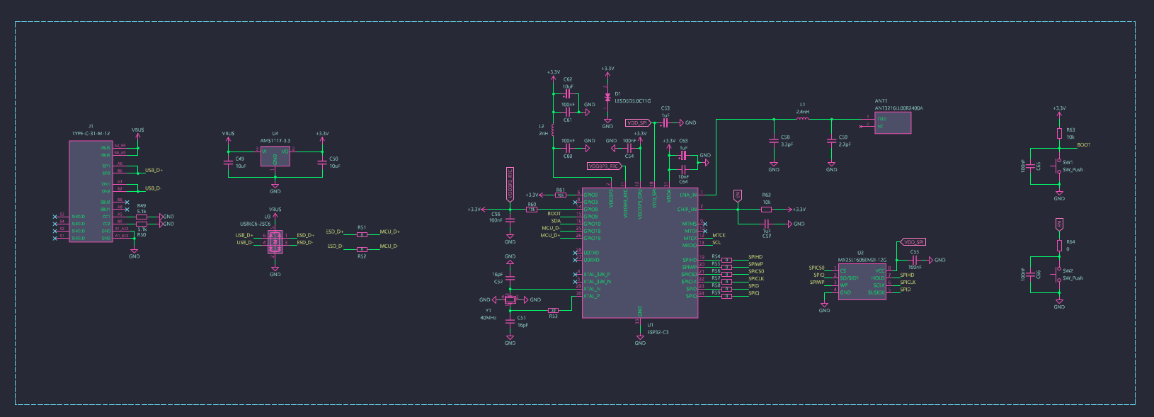

Postby he_elsayed » Wed Oct 02, 2024 9:17 am
I have attached the schematic of the circuit I am using. If there is information missing please let me know and I will provide it. I appreciate any help in advance!
Whenever I connect to power while holding the boot button down I see the following in the serial monitor:
ESP-ROM:esp32c3-api1-20210207
Build:Feb  7 2021
rst:0x15 (USB_UART_CHIP_RESET),boot:0x5 (DOWNLOAD(USB/UART0/1))
Saved PC:0x400462dc
waiting for download

When I run monitoring after this I get the original message that it is still waiting for download. I press the reset button and then get an endless bootloop that repeats over and over:

I am not sure whether this is a hardware or a software problem. I am trying to flash the basic hello world program from esp idf. Any feedback would be much appreciated as I have been struggling for the past days with this.

Solved it after days of scratching my head. It was due to the flash mode, setting it to DIO as indicated in the bootloop doesn't work. I had to use an older version of the firmware that supports DOUT and use DOUT as flash mode. That works. Hope this helps someone in the future.
