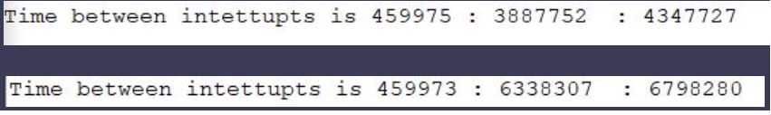

I seek help to use high priority interrupts.
I use a digital output from a ESP32(Pin 19), to trigger interrupts on 2 other ESP32s(Pin 23).
wire Connection is like,
    ESP0:Pin 19 --> ESP1:Pin23
      ESP0:Pin 19 --> ESP2:Pin23
      This should mean that when ESP0 triggers a digital output, an interrupt is triggered on ESP1 and ESP2.
      I do this twice and mark the time difference between the 2 interrupt arrives on ESP1 and ESP2.
      I want this time to be the same on both ESP1 and ESP2 but in reality one of the ESP1(or ESP2) is always slower than the other by 2 to 10 micro seconds.
      Here is the code for ESP1 and ESP2 interrupt creation.

      Here is the code for interrupt handling
      static void IRAM_ATTR zero_i_isr(void *arg) {
        BaseType_t xHigherPriorityTaskWoken;
        xHigherPriorityTaskWoken = pdFALSE;
        static int j = 0;
        j++;
        time_test[j] = micros();
        vTaskNotifyGiveFromISR(Calc_Time, &xHigherPriorityTaskWoken );
        portYIELD_FROM_ISR();
      in Calc time task, I just print the time difference
       if (j == 2) {
          Serial.printf("Time between interrupts is %lu : %lu  : %lu\n", time_test[2] - time_test[1], time_test[1], time_test[2]);
          j = 0;
      1. Why is there a time difference in interrupt handling between the two ESPs although they are receiving the interrupts at the same time?
      2. I have used ESP_INTR_FLAG_LEVEL3 while registering interrupt. If I try to use ESP_INTR_FLAG_LEVEL4 ESP_INTR_FLAG_LEVEL5 ESP_INTR_FLAG_LEVEL6 or ESP_INTR_FLAG_NMI , software crashes all the time. What should I do in order to use high prio interrupts like ESP_INTR_FLAG_NMI?
      3. Will using high prio interrupts solve the problem with the time delays that I am facing now?
