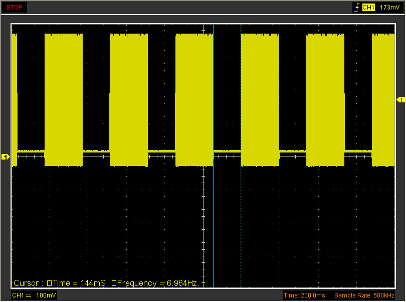

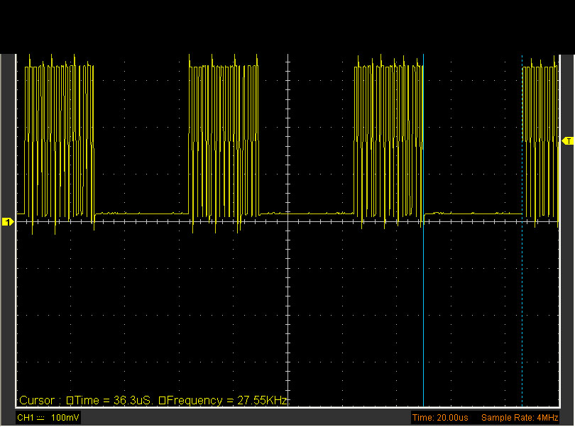

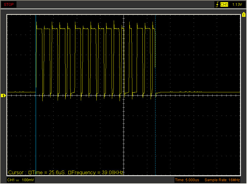

Re: DMA to GPIO for generating dshot signal
I used RMT to generate the signal and the result is strange:
-Signal frames are generated precisly and correctly -> Good
-Unexplicable 35us delay between frames -> Not good
-Huge delay of 140 ms that seems like a reset or something like that... -> Not good at all
Here is the code (I use arduino IDE):
Here is the result with dezooming progressively:
With a 5us division, we see the signal is OK: With 20us division, we see that we have 35us between frames. I expected less than 10 (delay of 1us and the computing takes 7us). It can be reduced to 20 with setting wait_tx_done to 0 for rmt_write_items :
With 200ms division, we see a huge delay of 144ms! :
So the questions I have this time are:
-What is causing that delay between frames and the huge delay of 140ms?
