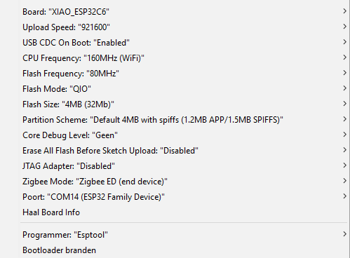

I've been trying to upload the Zigbee_Light_Bulb example to a Seeed Studio XIAO ESP32C6 but it keeps crashing.
I've selected the board as seen in the attachments. When I open the serial monitor I see these messages:
18:50:29.372 -> Guru Meditation Error: Core  0 panic'ed (Load access fault). Exception was unhandled.

Can you decode that stack trace?
How do I do this? I dont have a lot of experience with using ESP devices.

Sadly I cant open the terminal of the one you send and other ones. But I just used the example so it should work right.

Oh and btw I also tried to program it in Visual Studio Code and it worked there. But I really want to use the Arduino IDE and language.

I have the same problem, I tried it on the Seeed Studio XIAO ESP32C6 board and the ESP32-C6-DEVKITM-1-N4 board. Tested on Arduino IDE 2.3.3 with ESP32 3.0.7 .
