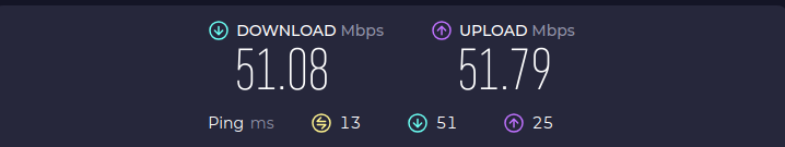

For all who are not bored reading my posts and still are interested to see more tests with P4 here is interesting component from espressif which is supporting all kind of network bridging. I prepared this PR to support P4:
https://github.com/espressif/esp-iot-bridge/pull/92
This is wired_nic example which is bridging USB and internal EMAC.
Screenshot from 2024-11-07 13-33-54.png (15.57 KiB) Viewed 3743 times
