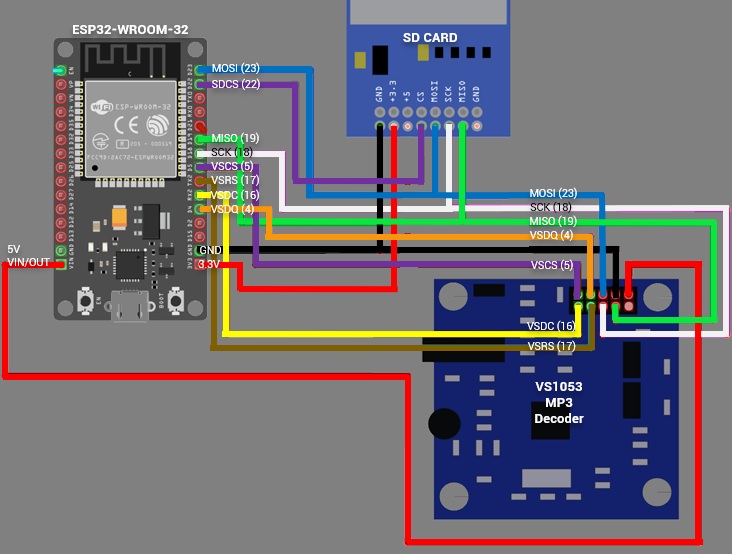

I have configured the pin connection between ESP32-WROOM-32, SDCARD and VS1053 as shown picture below and able to detect the SD card but failed to detect the VS1053 module at .begin() instruction of Adafruit VS1053 Library. The VS1053 module board is powered by 5V input but on board is operating at 3.3V.
VS1053 ESP32-WROOM-32 connection.png (126.45 KiB) Viewed 1256 times

Anyone successfully detected VS1053 module using Adafruit VS1053 Library on ESP32-WROOM-32 under Arduino platform, your feedback is greatly appreciated.
I do not want to use GPL related library related licenses to program VS1053, only Adafruit VS1053 library is preferred.
Please advise.

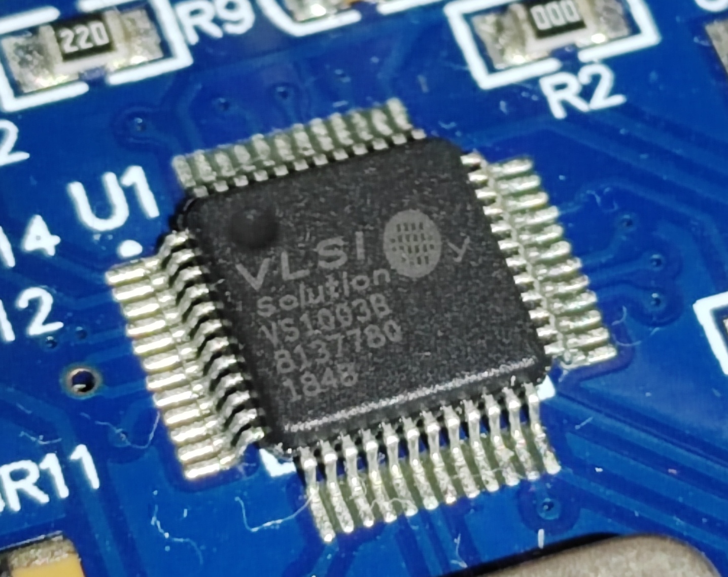

I just noticed the model of the VLSI chip is VS1003B, may be this is the reason the Adafruit VS1053 library failed to detect.
