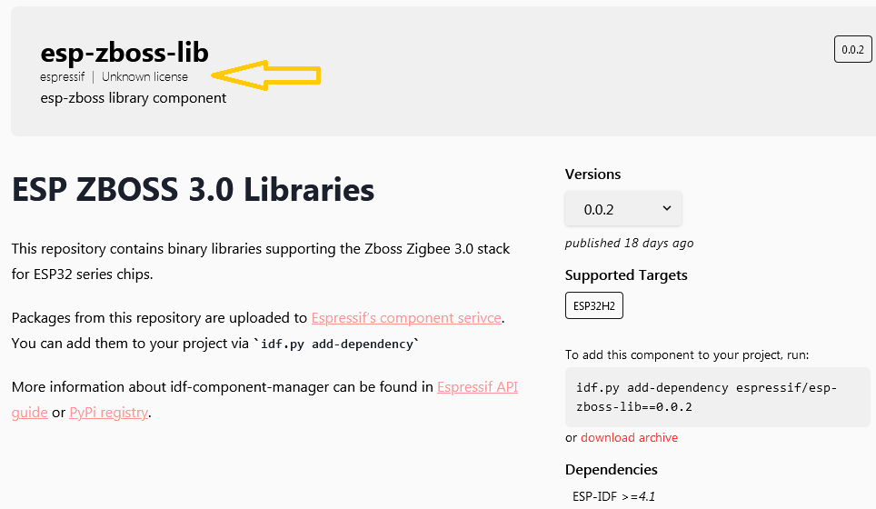

hi ivan.. you could try some of the zigbee examples which just got added to ESP-IDF: https://github.com/espressif/esp-idf/tr ... ght_sample.
This repository contains binary libraries supporting the Zboss Zigbee 3.0 stack for ESP32 series chips.
Are DSR Corporation, Denver CO, USA / Espressif Systems (Shanghai) PTE LTD planning to publish the SRC code as well?
The Unknown license what guise / set of rules is it?

Sorry, I don't think so. According to the Zigbee people in Espressif: "The Zigbee core stack and porting will be all closed source, since our Zigbee stack is from ZOI (https://dsr-zoi.com/), which we cannot open source."
The license seems pretty readable to me, is there anything in there that you don't understand?

txs Jeroen,
i thinked so - no problem - i see it likewise the wifi blob then.

but what does section 3 actually say and what does that mean:
"* 3. Neither the name of the copyright holder nor the names of its contributors
* may be used to endorse or promote products derived from this software without
* specific prior written permission.
does this mean we can not say "ESP32-H2-ZigBEE Device" ("Espressif's ESP32-H2 inside") like the USB Org it does handle ( no pay - no USB brand use )
and if we want use the Brand "ZigBEE" in the product we need written permisson from
DSR Corporation, Denver CO, USA / Espressif Systems (Shanghai) PTE LTD ?
it's not easy to name a (ZigBee) product with espressif's SoC inside without name it with/by the SoC name
and what H2 does "ZigBEE"
maybe I see that too closely , so I prefer to ask .

TBH, it was actually more because of the named "Unknown License".The license seems pretty readable to me, is there anything in there that you don't understand?

The clause in the license prohibits you to use the fact that DSR Corporation or any other contributers wrote the code as marketing - a sentence like 'Our product is created with code from the world-famous DSR Corporation, so you know that there won't be any bugs in there!' would be forbidden by the license.
The licensing on Zigbee and related terms seems to be governed by this document. To me it seems you're not allowed to use the trademark unless you're a member of the Zigbee Alliance, but that document contains a bit too much legalese to me and I don't really know the first thing about trademark law to be sure how much that would impact any ESP32-H2 user.
(Note that I am not a lawyer and this is not legal advice.)
