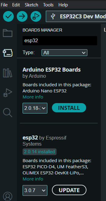

hi! i also had this problem , the problem is the newer esp32 core version. Please downgrade this to 2.0.14. if you dont know how.. just go to the arduino ide and select board manager ( you can find this on the left side of the ide ) then search esp32 (by espressif not arduino ) and select version 2.0.14 and download it . you can now use the tft_espi library. :D
