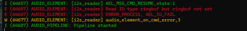

In the hfp example, I successfully connect to the phone via Bluetooth. Then, when I make a phone call to use the hands-free feature, I get an error as follows:

E (22369) AUDIO_ELEMENT: [i2s_reader] Read IO type ringbuf but ringbuf not set
E (22379) AUDIO_ELEMENT: [i2s_reader] ERROR_PROCESS, AEL_IO_FAIL
W (22379) AUDIO_ELEMENT: [i2s_reader] audio_element_on_cmd_error,3
I (22389) AUDIO_PIPELINE: Pipeline started
ESP32 lyrat mini adf hpf example error

Re: ESP32 lyrat mini adf hpf example error
In esp32 pipeline hfp example, microphone and speaker are set in i2s settings with this line
#define I2S_STREAM_CFG_DEFAULT() I2S_STREAM_CFG_DEFAULT_WITH_PARA(I2S_NUM_0, 44100, I2S_DATA_BIT_WIDTH_16BIT, AUDIO_STREAM_WRITER)
so i2s set for microphone was not working correctly, that was why ringbuf set error. I fixed it by making it a reader, ringbuf set error is gone but microphone is still not working, my voice is not reaching the other party while talking on the phone
