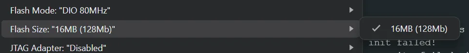

I am trying to program a custom ESP32-S3-WROOM-1 chip. I have connected a GY-91 sensor to it, and I’m trying to program the ESP32 to read the data from the sensor and print it in the serial monitor. However, whenever I run the code, I get the following error:

E (102) spi_flash: Detected size(8192k) smaller than the size in the binary image header(16384k). Probe failed.
assert failed: do_core_init startup.c:350 (flash_ret == ESP_OK)

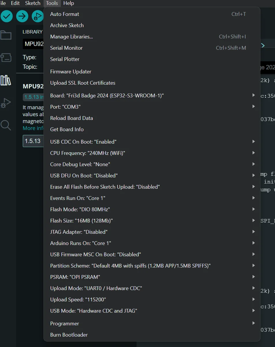

Is this an error with the code, or is there something wrong with my settings?
I tried to change the flash size to 8 MB, but I only have the option of one flash size.

lbernstone
Posts: 1132
Re: Error programming custom ESP32-S3-WROOM-1
Postby lbernstone » Fri Jan 03, 2025 6:10 pm
That board definition is for a very specific product which doesn't match your hardware. You should either use the ESP32-S3 reference board, or add this to a boards.local.txt in the same folder as your boards.txt (likely C:\Users\%USERNAME%\AppData\Local\Arduino15\packages\esp32\hardware\esp32\3.0.7\):
fri3d_2024_esp32s3.menu.FlashSize.8M=8MB (64Mb)
fri3d_2024_esp32s3.menu.FlashSize.8M.build.flash_size=8MB
