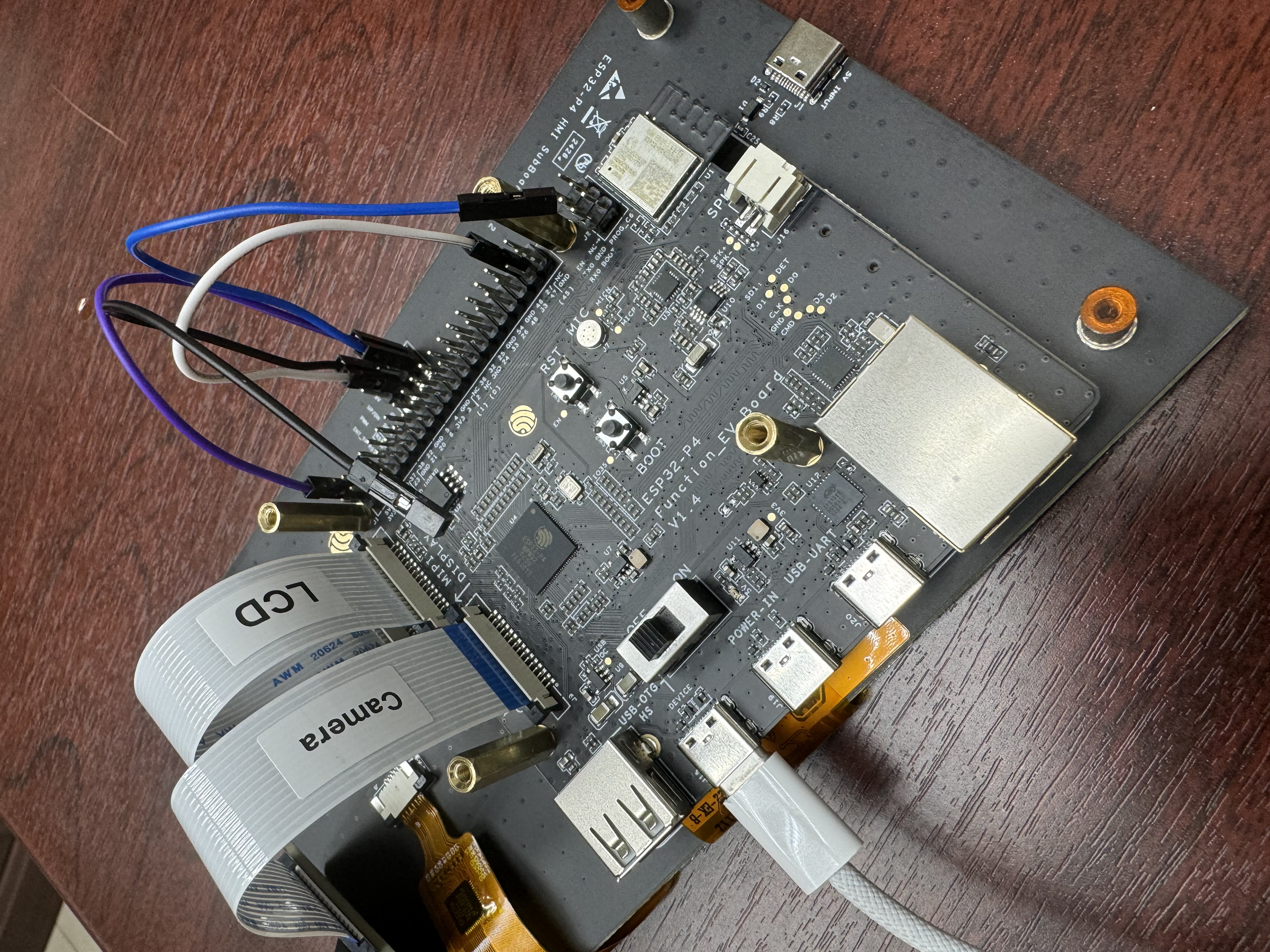

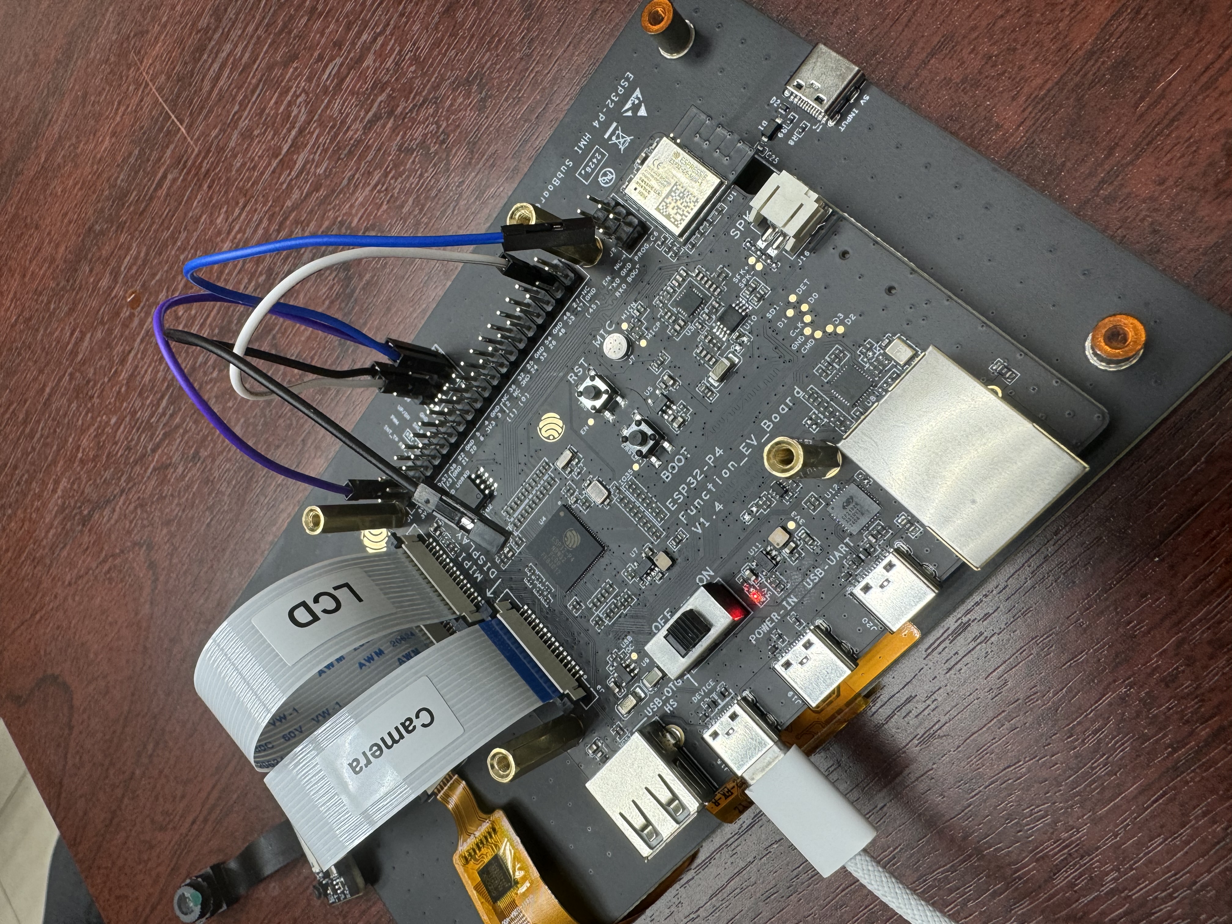

ESP32 P4 EV Kit touch not working
real_mon2
Posts: 27
Joined: Wed Dec 25, 2024 4:59 pm
Re: ESP32 P4 EV Kit touch not working
Postby real_mon2 » Tue Jan 14, 2025 12:55 pm
see attached. Thanks.
Minatel
Posts: 433
Postby Minatel » Tue Jan 14, 2025 2:36 pm

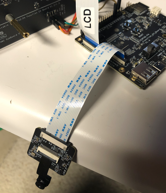

The flat on the camera board is inverted. The blue part should be on the top.
real_mon2
Posts: 27
Postby real_mon2 » Tue Jan 14, 2025 2:44 pm

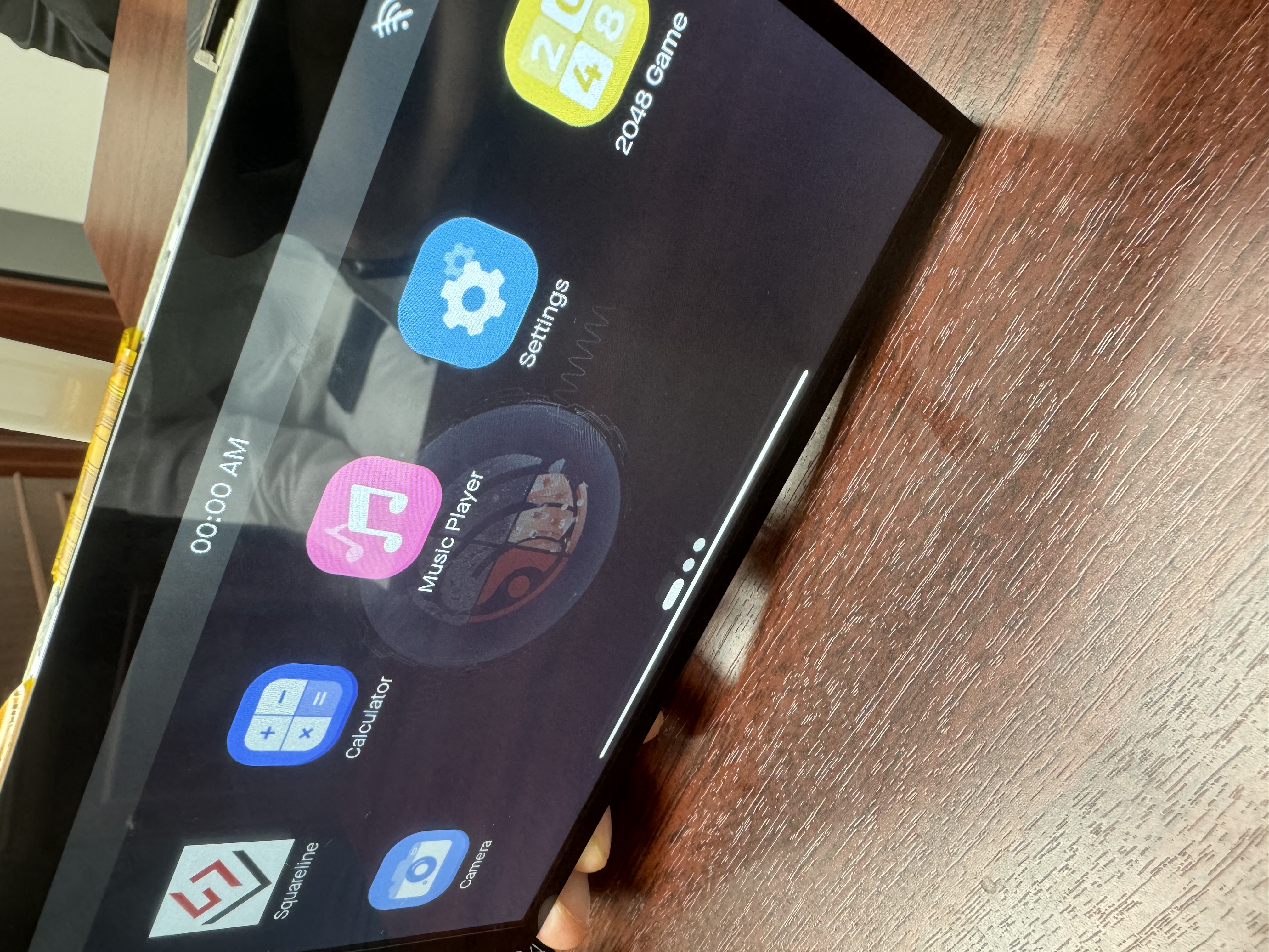

OMG! Yes, you are correct. Now working as it should. The camera works.
Watched this video for the cabling:
https://www.youtube.com/watch?v=pNR05RORfg8
We must have done it wrong. Thanks so much for the great support!

Hello , I have the same problem as you and I attached it correct but the touch still not working is there any problem with wire connection or what ?? Thank you
Minatel
Posts: 433
Postby Minatel » Fri Jan 24, 2025 8:37 am
Yes, same problem.
Change the direction of the camera flat cable. As you can see on the display flat, the blue part should be on the same side.
