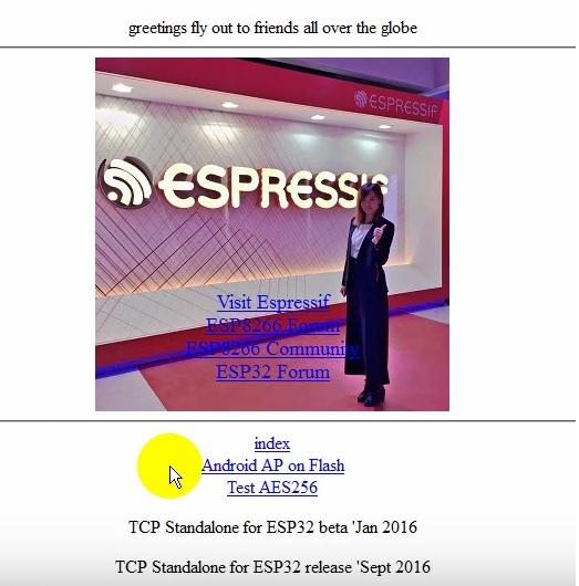

If connected, then start Browser, navigate to:
Start/Index/Home
http://192.168.4.1/
You can test GPIO 22 ( Low, High )
http://192.168.4.1/gp0
http://192.168.4.1/gp1
You can test onBoardTemperarure Sensor
http://192.168.4.1/Tempsensor
You can test with an Android Device too.
Surf with your Android Device to the Wifi and connect it.
Navigate http://192.168.4.1
and download by link
or
Navigate directly from
http://192.168.4.1/ESP32AP.apk
After download, install Android APP and open it.
now you can connect to the ESP32 beta by wifi
and you can switch GPIO 22

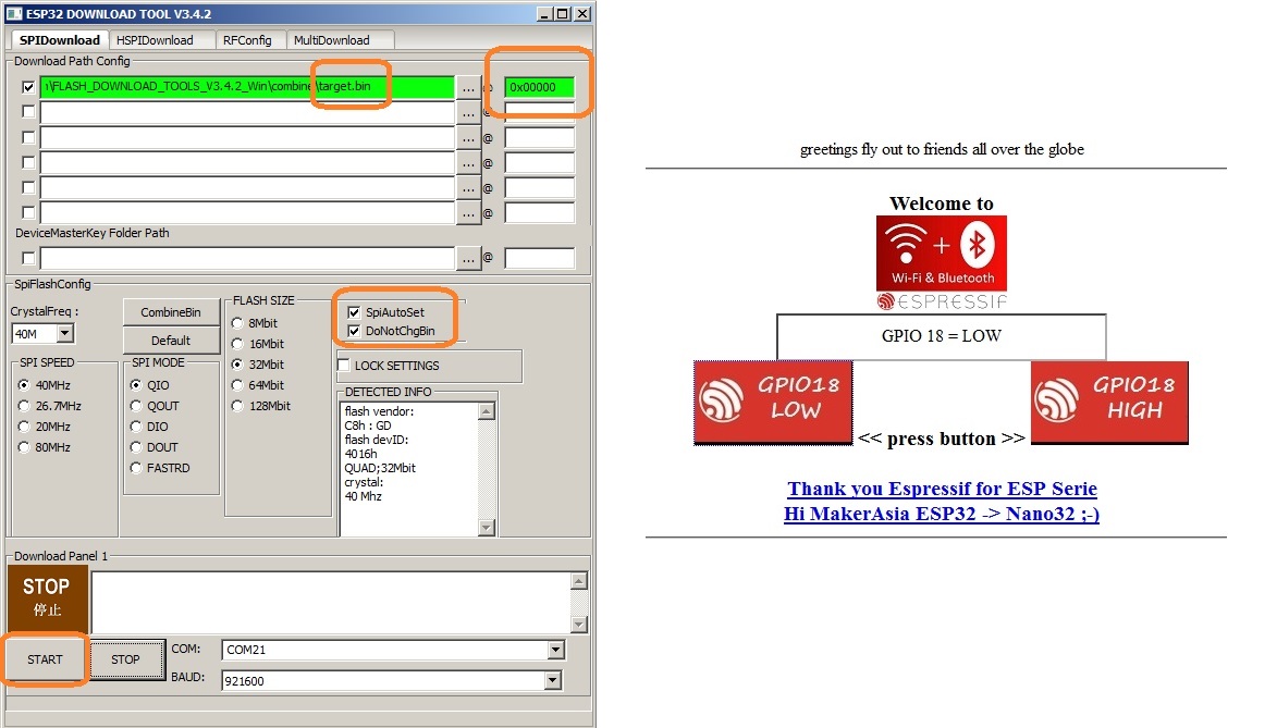

how to:
YouTube: how you flash and run
Update
ESP32 Version
24 / 30 September 2016
update for ESP32
use the new flash tool 3.4.2 ( windows )
only rename the zip file to bin
ESP32 File
target_0x00000.bin.zip
(778.37 KiB) Downloaded 1708 times
load the bin in flash tool like picture
setup address 0x00000
flash it
switch LED on GPIO 18
reboot the Board
connect the Soft AP
