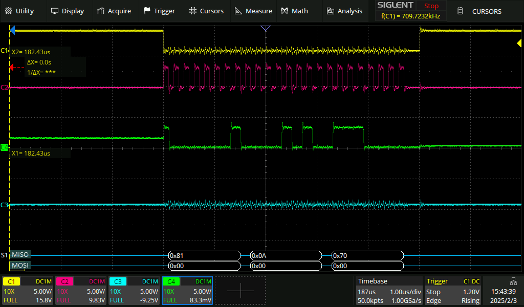

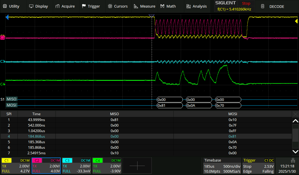

My ESP32S3 is communicating with a TI DAC 81401 via SPI. As per the datasheet, the 81401 uses CPOL=0, CPHA=1, ergo MODE_1.
For some reason though, the ESP32 does not properly detect the answers. It comes out as 1 bit shifted to the right, i.e. where I should be getting 810A70, I'm getting 0214E0.
The scope's SPI decoder is in line with what TI says. MOSI seems to be okay, since the TI DAC does what it's supposed to be. Here's a screenshot:
C1=CS, C2=SLCK, C3=MOSI, C4=MISO (mixed MISO and MOSI up @ the scope)
This is even with very low bitrates (1MHz) -- do you have any idea what could be wrong?
Huh??? The scope traces are supposed to be digital signals?!
How can they degenerate so much? It looks like you have huge capacitances on&between the lines.
Master+slave are connected to a common GND?

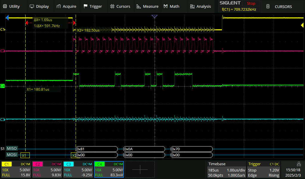

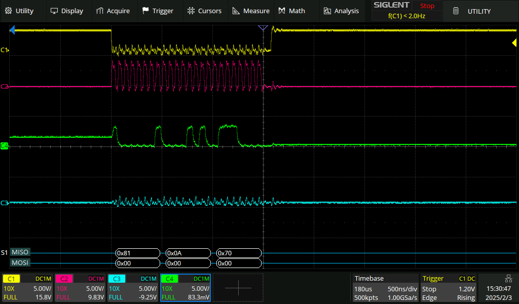

I rewired and used scope probes w/ 10x. Does that look better now?
Here with a slower bitrate:
Still the same outcome though. The scope correctly detects 810A70, the ESP32 detects 0214E0.

Postby DrMickeyLauer » Mon Feb 03, 2025 2:59 pm
I take that back. It might have been a combination of bad wiring and bad configuration. The TI DAC's SDO pin can be configured whether it latches @ rising or falling edge ­– irrespective of being a CPHA=1 device. In some of my tests I had that configuration backwards and with different settings it now seems to work:
Here we see that the bit is valid @ the falling edge and this seems to be what the ESP32 expects when using CPHA=1. Phew.
