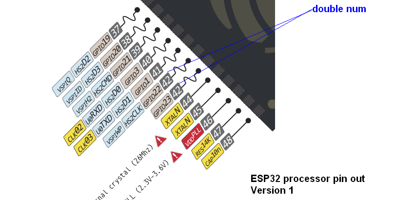

So ESP31 vs ESP32
Pins 36-45 are different pinout, mostly just rearranged.
ESP32 loses Vdigital supply input which is used for digital IO logic levels? Instead is combined with Vpll? Or Vcore?
ESP32 gains GPIO23 pin @ pin #42
No labels for RTC_GPIO pins yet? Pins 10 & 11?
GPIO #1 is mirrored on two pins but alternate functions are different?

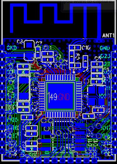

Re: [Documentation Release] PCB of ESP32 Module
The PCB layout file (.pcb) is in PADS format. You can get a free viewer at http://www.mentorgraphics.com.
- ESP32_layout.JPG (86.98 KiB) Viewed 25757 times
