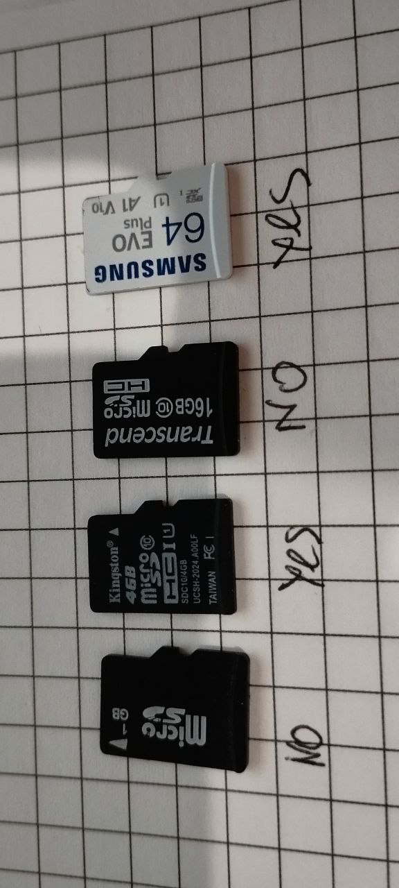

Hello. In my project, I use storing the web interface on a memory card. I couldn't get ESP 32 to recognize the card for a very long time. I've tried a lot of options.
regular microsd 1gb - error (type not supported)
16GB microsdhc memory card - CRC verification error
4gb MICROSDHC U-1 memory card - everything is fine
64gb Samsung evo microsd U-1 - everything is fine
(pullup-s enabled)
See file below
I don't need to use memory cards > 4gb

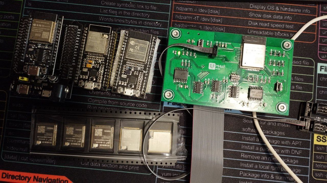

SO, I tested many variants. Module I use are:
All modules based on ESP-WROOM-32 ESP32-WROOM-32UE

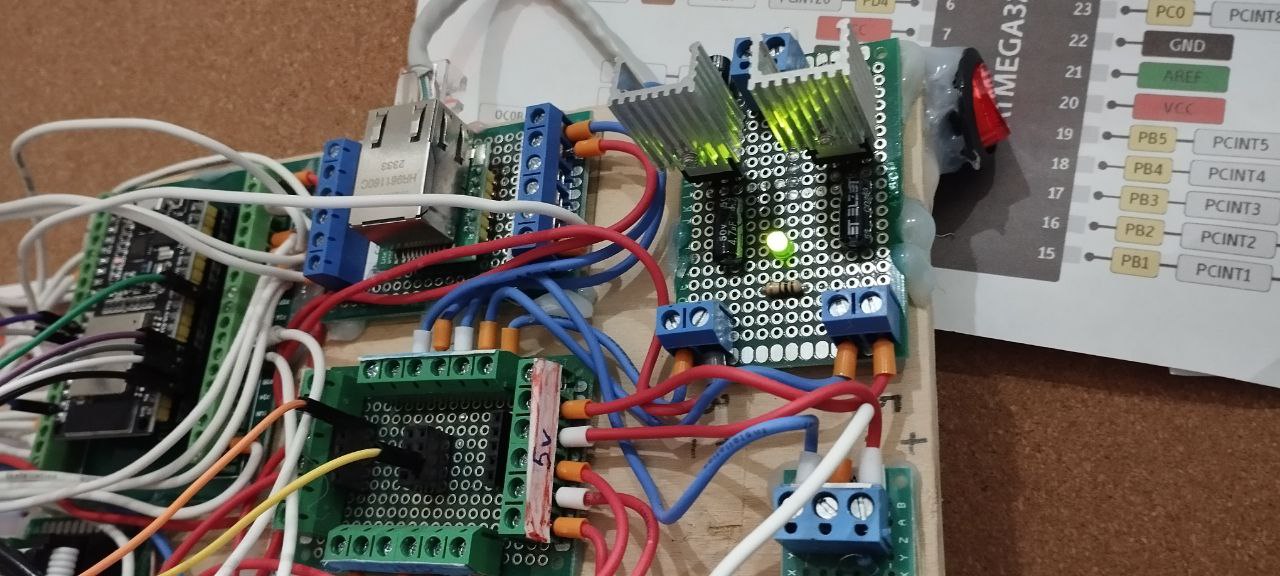

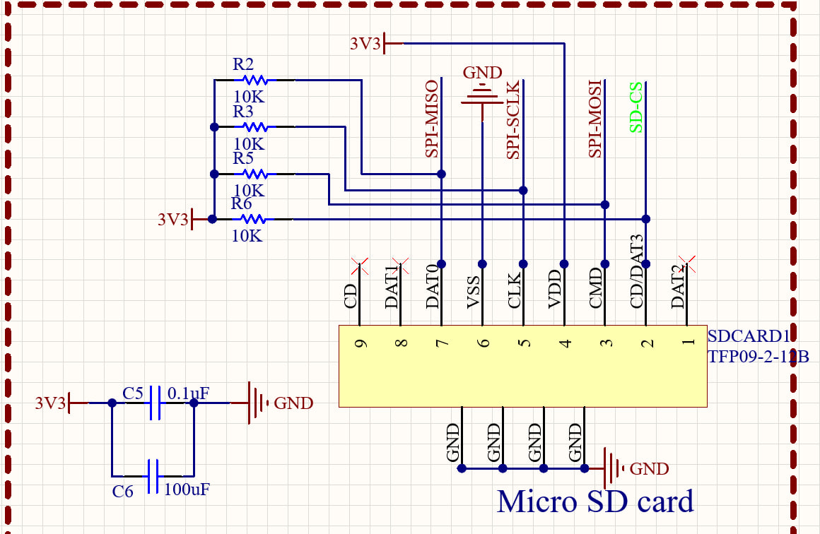

Adapter I using has 10K pullup resistors, also on my custom board pullup resistors exists too.

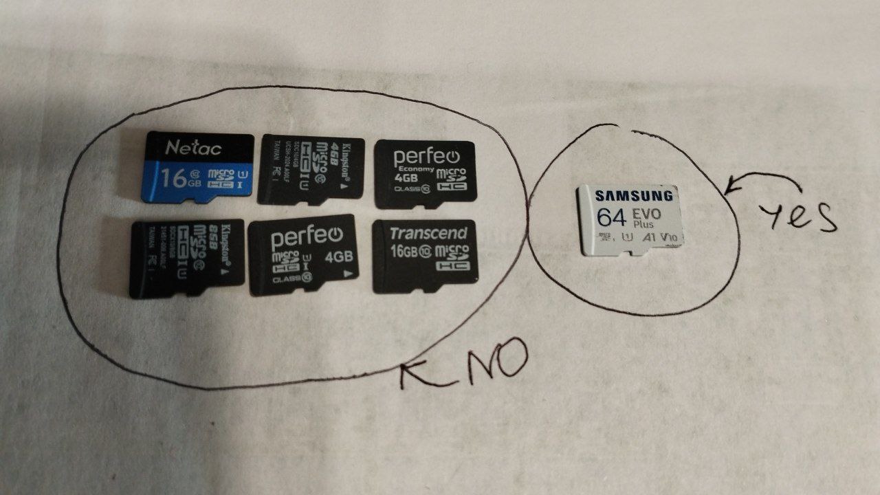

Cards I using:
Of course, I would like to save money and use 4-32GB memory cards.

Schematics I using on custom board:

But other SD cards - ERROR. Can you help me to solve problem?

I wouldn't completely exclude the influence of the power supply. See the issue reported here
https://github.com/espressif/esp-idf/issues/12986
I do not see where does your board get the power. I assume the power supply in your case is provided by the ESP programmer. You may try to power the board using external 3.3V power supply and retry the failing cards as this approach helped the linked issue.

Hi! I am usin also LD33V (3,3V 1A) voltage regulator.
How much energy consumption of microsd?

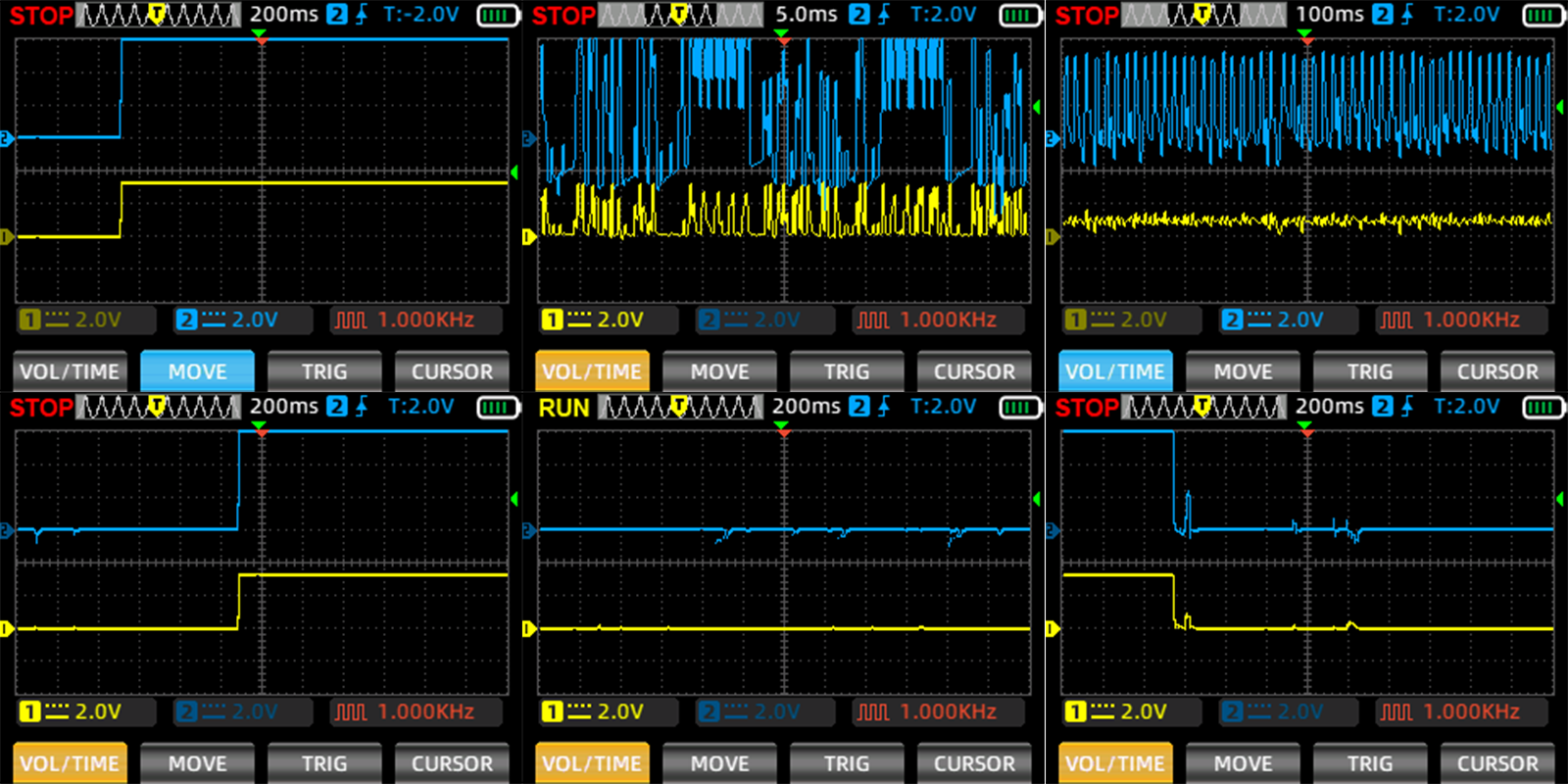

Postby sazanof » Mon Feb 10, 2025 6:57 pm
You may check the signal idle voltage levels at your SD card and if you have oscilloscope, then also the voltage range of the signal to exclude the cases described in the links above.
I'm not good at working with an oscilloscope. Here's what happened to do. If I did something wrong, please tell me how to connect what and where to measure the signal.
1 channel - MISO
2 channel - MOSI
Tests with working card. the screenshots show the moment when the sd card is turned on and the moment when it is read.
