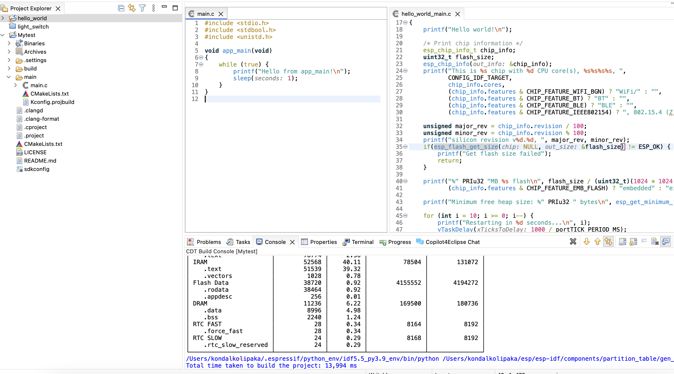

well, can we address the LSP editor fake errors highlighting?
the thing is when clang for simple (only 'main.c') ESP32 Eclipse project is invoked from cmd console, it says nothing but silently generates the 'main.o' - it definitely knows where the 'stdio.h' is.
the installation is fine and ''compile_commands.json' is generated properly. seems to me, there is not so complex issue...

I tried with the default project and the hello-world project in Espressif-IDE 3.2.0, but I don’t see any false error markers on the editors. Could you verify the Clangd settings to ensure they are auto-configured correctly? You can check using Preferences >Editor(LSP) > Clangd
I am attaching my settings for reference for ESP32.
- Screenshot 2025-02-14 at 1.19.05 PM.png (1.49 MiB) Viewed 6299 times

my settings:
all paths are correct. please note:
- it's windows, not linux.
- even if "d:\idIoT.Users\KDV\.espressif" is NTFS symlink, clang handles these paths with no problems when invoked by cmd console command.
