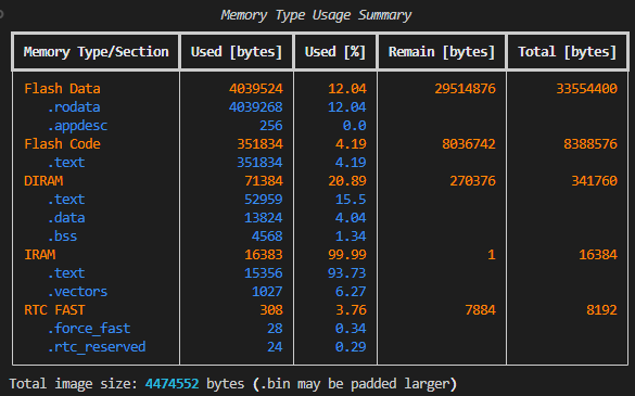

ESP32-S3, with 16MB or Flash, and 8MB of PSRAM.
When ESP-IDF v5.4 compiles it produces the summary below:
How does this summary showing 42MB of Total available Flash make sense?
No mention of PSRAM.
No mention of internal ROM
ESP32 Memory summary.png (18.92 KiB) Viewed 1662 times

Hi
- 4 474 552 - is not 42MB
- you have setup 32MB in sdkconfig, i think, because its what the total bytes show

I'm not talking about the resulting code size, but rather the total bytes available as shown in the right most column

Ok, thats fine. But its still 32MB, thats why i said this
Just check with idf.py menuconfig

In Menuconfig, its set to 16MB.

You are correct, idf.py size seems to be broken.
I thought it may be only on P4, but on S3 it shows very odd values too (maybe other models too)
                            Memory Type Usage Summary
┃ Memory Type/Section ┃ Used [bytes] ┃ Used [%] ┃ Remain [bytes] ┃ Total [bytes] ┃
│ Flash Code          │      1312083 │    15.64 │        7076493 │       8388576 │
│    .text            │      1312083 │    15.64 │                │               │
│ Flash Data          │       376608 │     1.12 │       33177792 │      33554400 │
│    .rodata          │       340736 │     1.02 │                │               │
│    .bss             │        35616 │     0.11 │                │               │
│    .appdesc         │          256 │      0.0 │                │               │
│ DIRAM               │       262932 │    76.93 │          78828 │        341760 │
│    .text            │       171807 │    50.27 │                │               │
│    .bss             │        70936 │    20.76 │                │               │
│    .data            │        19964 │     5.84 │                │               │
│ IRAM                │        16384 │    100.0 │              0 │         16384 │
│    .text            │        15356 │    93.73 │                │               │
│    .vectors         │         1028 │     6.27 │                │               │
│ RTC FAST            │           52 │     0.63 │           8140 │          8192 │
│    .force_fast      │           28 │     0.34 │                │               │
│    .rtc_reserved    │           24 │     0.29 │                │               │
Total image size: 1861258 bytes (.bin may be padded larger)
with values
CONFIG_IDF_TARGET="esp32s3"
CONFIG_ESPTOOLPY_FLASHSIZE_4MB=y
- flash size 4MB
- size shows flash code total bytes 8MB
- flash data total bytes 32MB
