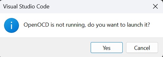

I have been working for a few days to get ESP-IDF working in VSCode. Followed every tutorial and video on the internet almost, but got it working now.
I have an ESP32-S3 with a dual USB (one UART and one JTAG).
I am now able to flash the module using UART, on either port.
Now I am moving to debugging.
Followed the instructions, installed the USB driver for the embedded JTAG interface, changed the interface in VSCode from UART to JTAG. And clicked flash. Not yet at the debugging. When I do, I get the attached prompt. I say yes to launch, then get the following.

Then I keep getting this in the VSCode notification.
Error: non zero exit code 1 The following Python requirements are not satisfied: Requirement 'setuptools<71.0.1,>=21' was not met. Installed version: 75.3.0 To install the missing packages, please run "install.bat" Diagnostic information: IDF_PYTHON_ENV_PATH: C:\Users\Hassa\.espressif\python_env\idf5.3_py3.11_env Python interpreter used: C:\Users\Hassa\.espressif\python_env\idf5.3_py3.11_env\Scripts\python.exe Constraint file: C:\Users\Hassa\.espressif\espidf.constraints.v5.3.txt Requirement files: - C:/Users/Hassa/Desktop/esp-idf/tools\requirements\requirements.core.txt Python being checked: C:\Users\Hassa\.espressif\python_env\idf5.3_py3.11_env\Scripts\python.exe ESP-IDF v5.3.1 at ChildProcess.<anonymous> (\dist\extension.js:2:1421636) at ChildProcess.emit (node:events:519:28) at Process.ChildProcess._handle.onexit (node:internal/child_process:294:12)
I know all these are clearly why I am not able to flash with JTAG, the question is, is there a manual or step by step to fix all this. My assumption would have been that the Extension would have taken care of all of this, but clearly there is a lot of manual setup that I need to do which for the past 2 days I have been. Now I am stuck here.
For example, when I get use install.bat...where and how.
I am not an expert user, first time setting this up.

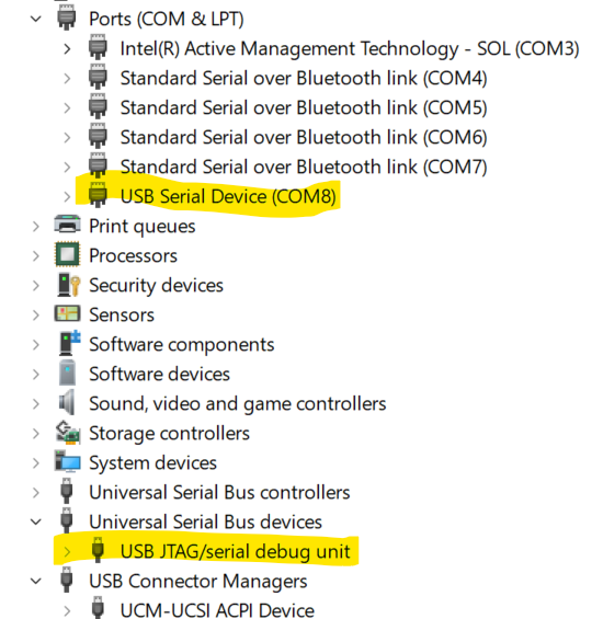

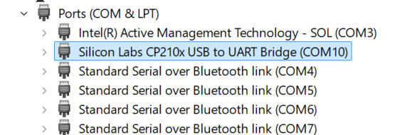

The esp32c6-devkitC-1 has two usb connectors
With one flashing and monitoring is possible. The device manager shows the Siliconlabs COM port Image.
Connecting the USB cable to the other connector enables not only flashing but also debugging. The device manager show USB Serial COM
port and an USB JTAG debug unit Image
