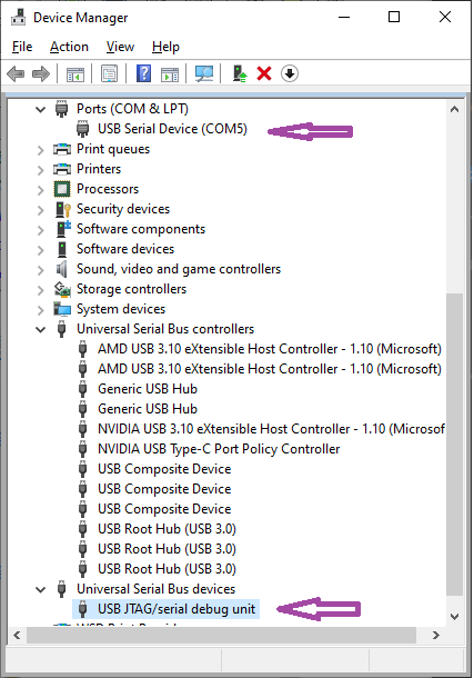

Trying to get the builtin USB-to-JTAG debugger running using ESP-IDE in VSC and running OpenOCD.
The USB driver appears to be running:
DeviceManager ESP32 USB-to-JTAG.png (26.64 KiB) Viewed 929 times

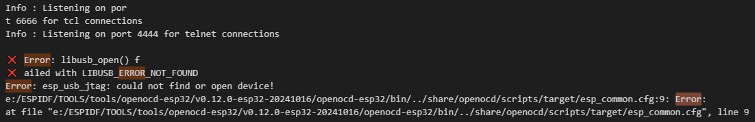

When attempting to start the OpenOCD Server:
OpenOCD fail.jpg (47.52 KiB) Viewed 929 times
I have searched and searched an can't find a solution.
I see nothing from Espressif that helps.

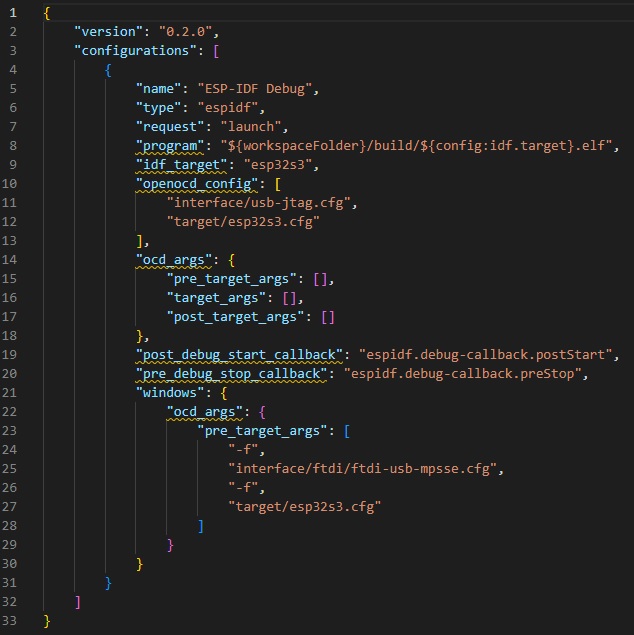

Various AI discuss creating a launch.json file. No real mention from Espressif
Shouldn't the OpenOCD server be pre-configured by ESP-IDE without a launch file??
I tried this launch.json file, but it still fails: Not sure it needs this file.

There are two ESP32 efuses which can disable the USB/JTAG interface, both are set to not disable the function:
Is this a driver issue? Notice the age of this driver, 19 years old....can this be the right driver?
JTAG driver.jpg (111.34 KiB) Viewed 815 times

It was the driver.
The 2021 driver can be found here
https://dl.espressif.com/dl/idf-driver/ ... -07-15.zip
While the OpenOCD Server is now running, it is reporting errors. More debug required

Re: ESP32 built in USB-to-JTAG debugger - HELP
Postby klaatu2 » Tue Mar 11, 2025 7:52 pm
That launch.json file also was not correct
Instead, I deleted it. then hit CTRL SHIFT P, and entered "ESP-IDF: Add vscode Configuration Folder"
That created a new launch.json file
And now the debugger seems to be running
Now to figure out how to use it
