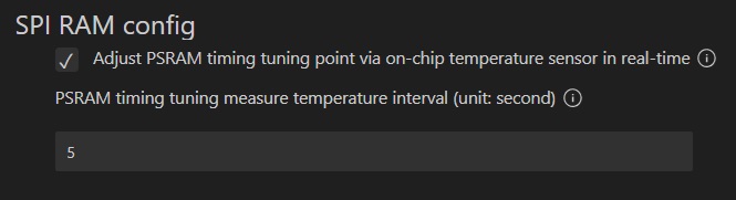

Hi @ESP_Sprite,
Error:
MSPI Timing: The flash model has not been verified support this feature, please contact espressif business support
cpu_start: init function 0x40380244 has failed (0x106), aborting
I enabled "Adjust PSRAM timing tuning point via on-chip temperature sensor in real-time", image in annex, i think this is the problem, but I think that it should work in this module ( S3-WROOM-2-N32R8V ).
W (1015) i2c: This driver is an old driver, please migrate your application code to adapt `driver/i2c_master.h`
I (1026) sleep_gpio: Configure to isolate all GPIO pins in sleep state
I (1033) sleep_gpio: Enable automatic switching of GPIO sleep configuration
E (1041) MSPI Timing: The flash model has not been verified support this feature, please contact espressif business support
E (1052) cpu_start: init function 0x40380244 has failed (0x106), aborting
--- 0x40380244: __esp_system_init_fn_psram_adjust_timing_point_via_temperature at C:/esp-idf/components/esp_hw_support/mspi_timing_by_mspi_delay.c:882
abort() was called at PC 0x42003290 on core 0
--- 0x42003290: do_system_init_fn at C:/esp-idf/components/esp_system/startup.c:135
Backtrace: 0x4037a1d5:0x3fceb190 0x40383da9:0x3fceb1b0 0x4038c69a:0x3fceb1d0 0x42003290:0x3fceb240 0x420032c9:0x3fceb270 0x40379cd9:0x3fceb2a0 0x403ccca9:0x3fceb320 0x403cd119:0x3fceb370 0x403c8a31:0x3fceb4b0 0x40045c01:0x3fceb570 0x40043ab6:0x3fceb6f0 0x40034c45:0x3fceb710
--- 0x4037a1d5: panic_abort at C:/esp-idf/components/esp_system/panic.c:454
0x40383da9: esp_system_abort at C:/esp-idf/components/esp_system/port/esp_system_chip.c:92
0x4038c69a: abort at C:/esp-idf/components/newlib/abort.c:38
0x420032c9: do_secondary_init at C:/esp-idf/components/esp_system/startup.c:184
 (inlined by) start_cpu0_default at C:/esp-idf/components/esp_system/startup.c:210
0x40379cd9: call_start_cpu0 at C:/esp-idf/components/esp_system/port/cpu_start.c:840 (discriminator 1)
ELF file SHA256: d229c243431a52a7
CPU halted.
