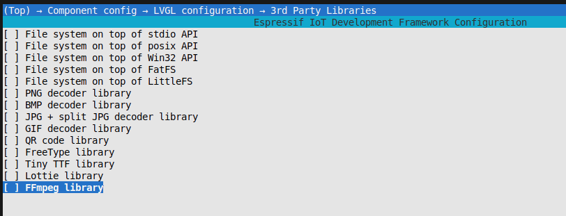

Does anyone know of any good alternatives to LVGL? I'm working with ESP32-S3 WROOM and need to display images in jpeg and png formats. LVGL documentation is not really helpful and I can't get things to display on my ST7701 driver based display unless I first manually convert an image into LVLG's preferred .bin format and have that image readily available, which is not a long-term viable process. Or if you've managed to make something like this work (ie, send over jpeg/png data to a buffer in esp32-s3 external PSRAM, and then get lvgl to display that on a ST7701 LCD), appreciate some feedback on how to proceed. Thanks.

With LVGL you should be able to display jpeg and png images, as there is option in menuconfig to enable decoder for each.
Screenshot from 2025-04-01 03-36-46.png (35.33 KiB) Viewed 555 times

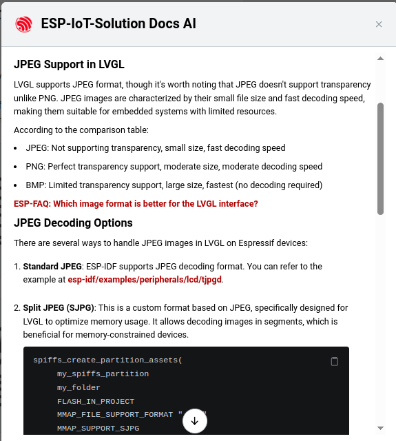

Also this is what i can find with "espressif" AI bot
https://docs.espressif.com/projects/esp ... ank-screen
https://github.com/espressif/esp-idf/tr ... /lcd/tjpgd
This is interesting
https://docs.espressif.com/projects/esp ... coder.html
Screenshot from 2025-04-01 03-46-37.png (97.16 KiB) Viewed 555 times
