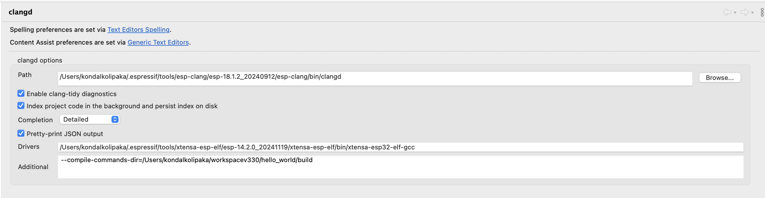

Could you please verify the following to ensure everything is auto-configured correctly?
1. Clangd Settings – Please refer to the screenshot to check whether the Clangd path is correctly configured. 2. F3 Shortcut – The F3 shortcut might not be working due to conflicts or configuration issues. Kindly verify this.

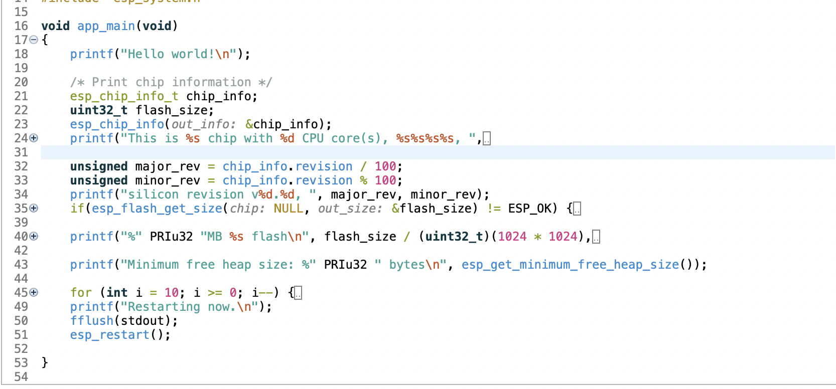

3. Code Folding – It seems that issue #1 might be affecting this. However, it appears to be working on my end (see the screenshot). Do you see any error in the log? Does closing editor and reopening works?
1. Unfortunately it seems I don't have "esp-clang" in my "tools" folder. How can I add it?

3. Since I didn't solve 1. so this point doesn't work as well.
