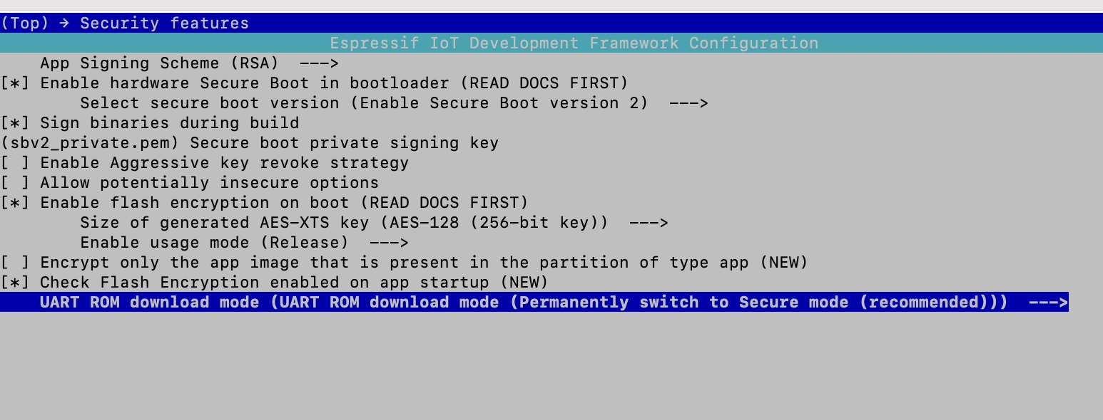

I have a project success enable Secure boot+Flash Encryption for ESP32, but when I change to ESP32-S3 it failed,
After I flash the boot loader and the application image, it show in the log:

Steps I use to enable both Secure boot and Flash encryption at the same time:
1, Flash Encryption, follow the official guide: https://docs.espressif.com/projects/esp ... lease-mode.
2, Secure boot v2, follow the official guide: https://docs.espressif.com/projects/esp ... re-boot-v2
3, Erase the flash and build the boot loader with command: idf.py bootloader and flash follow the output result.
4, Flash the remain part of the project with command: idf.py flash
Below is the screenshot with menuconfig:
This is the part of sdkconfig content to enable flash encryption and secure boot

The modules I use is official ESP32-S3-WROOM-1 N8R2 and N8, I also try IDF 5.1.4
Output by the command: esptool.py --chip esp32s3 --no-stub get_security_info
esptool.py v3.3.4-dev
Found 2 serial ports
Serial port /dev/cu.usbmodem101
Connecting...
Chip is ESP32-S3 in Secure Download Mode
Enabling default SPI flash mode...
Flags: 0x000006f5 (0b11011110101)
Flash_Crypt_Cnt: 0x0
Key_Purposes: (9, 4, 0, 0, 0, 0, 12)
Chip_ID: 9
Api_Version: 0
Hard resetting via RTS pin...
Due to the result the flash encryption is not enable, but the secure boot is enabled, but I don't know what is the problem, the code working fine on the chip if secure mode and flash encryption disable.
