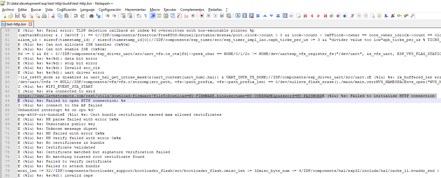

This works fine but I have the following problem.
As you can see the URL has embedded the user and password for server verification:
static const char *FIRMWARE_REMOTE_UPGRADE_URL = "https://www.lavnetremote.com/rest/utils/download-firmware?fileToDownload=MY-FIRMWARE.bin&username=MY-USERNAME&password=MY-PASSWORD";
The problem is the generated .bin file contains some kind of logs at the beginning with the result of a failing connection and someone could reveal the user and password.
I've tried to set log level to NONE or playing with the ".username" and ".password" properties of the http connection but the URL with this data is still in the .bin file.
Could you please let me know how to handle this?
Well, not quite. That section of the .bin contains, in no particular order, all string constants/literals used anywhere in the application, including strings used in log messages and your URL string. The URL string being located near logging strings in the .bin doesn't mean that the URL is used in any log messages. (You should find at least one byte of 0x00 between the URL and the surrounding strings.)

Any ideas on how to overcome this? I mean I want to hide somehow the credentials in the .bin file because I will be distributing this .bin file to final users so they can update through OTA (using UART or local wifi in facilities with no Internet access to perform HTTPS OTA)

You could encrypt the .bin file prior to distribution and decrypt it on the ESP during OTA.
You could also statically 'encrypt' only the URL string and 'decrypt' it to RAM at runtime ("obfuscation"). Not very secure (everything required for the 'decryption' (code + any 'key') would also be in the .bin file somewhere), but it prevents the secret from being easily spotted at a cursory glance.
