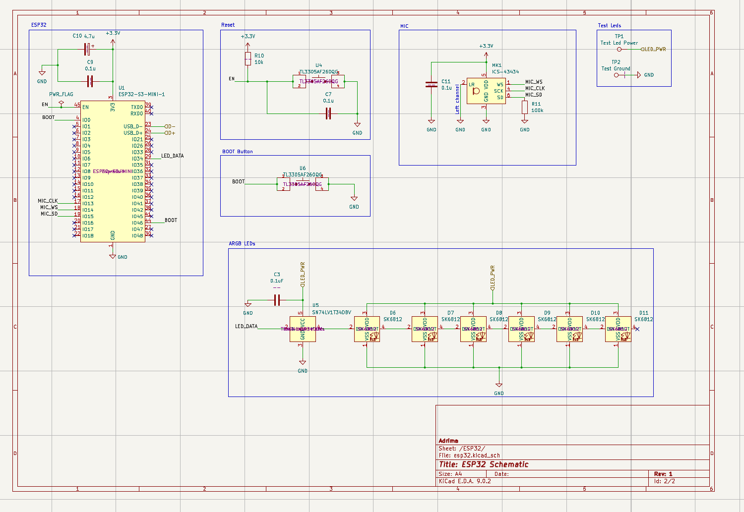

I have created my first custom PCB with an ESP32.
I received the PCBs today, and they don't work. I can flash the firmware. I tried it with WLED and the typical "hello_world" example. But it won't start. Nothing is shown on the serial monitor.
Everything looks fine; the power is ok, but it's not starting.
I can get the chip info and the mac info, but it never runs the program.
For WLED, the wifi AP is never created, and for the "hello_world" nothing is shown in the monitor.
Is there any way to find out what is happening?
If I reset the device, what I see is this:
ESP-ROM:esp32s3-20210327
Build:Mar 27 2021
rst:0x15 (USB_UART_CHIP_RESET),boot:0x0 (DOWNLOAD(USB/UART0))
Saved PC:0x40041a76
waiting for download

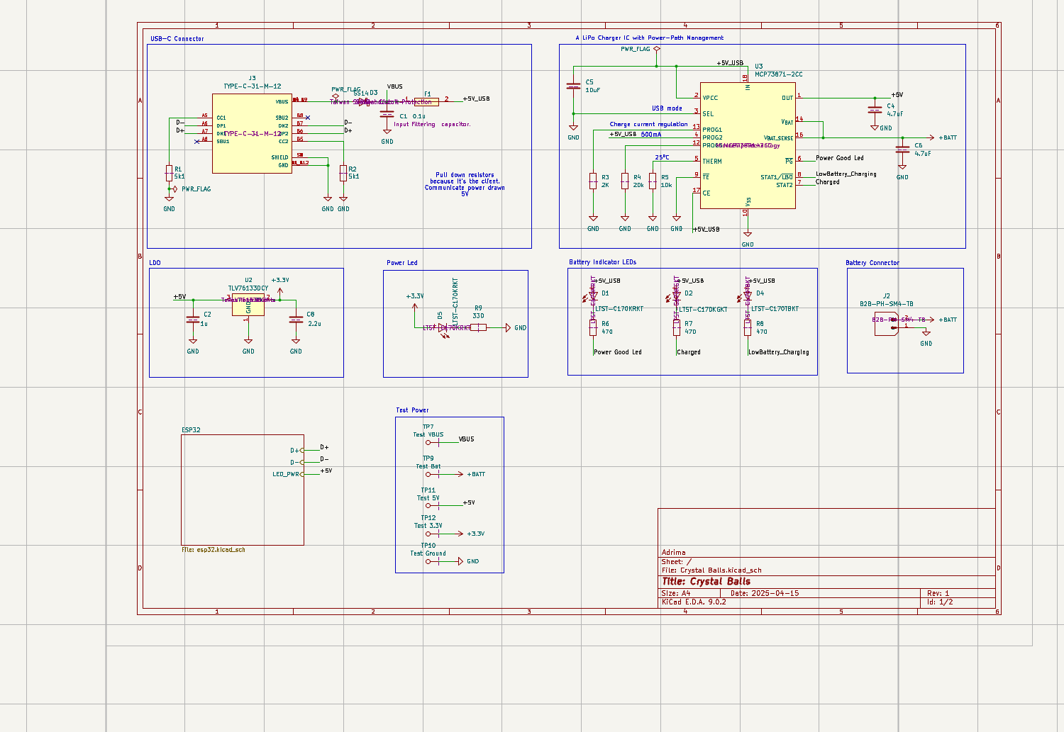

I attach the screenshots of the schematic.

Re: Custom PCB with ESP32-S3 won't start, but I can upload firmware
Postby Sprite » Tue Jun 17, 2025 12:36 pm
IO0 somehow is kept low. I don't see anything in your schematic that does this; perhaps you have a short, or some conducting flux residue left in place?
