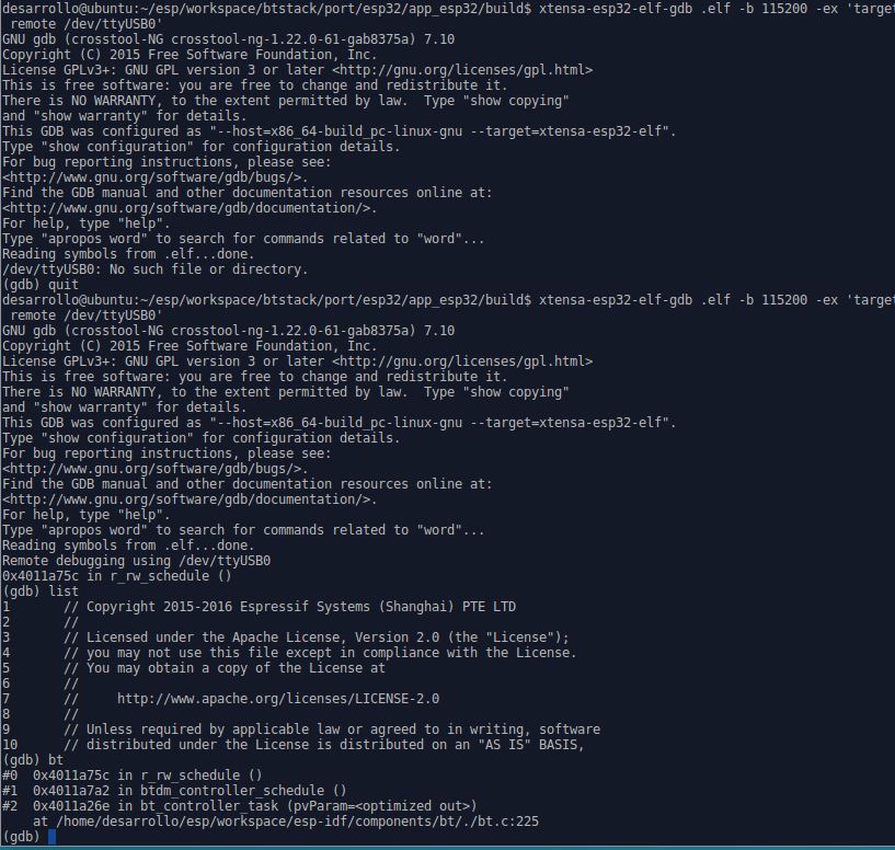

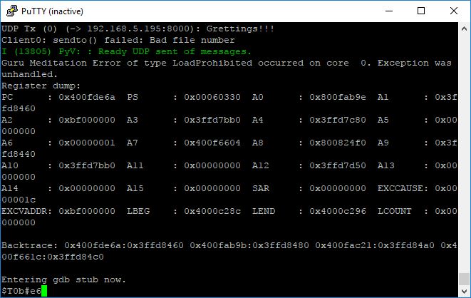

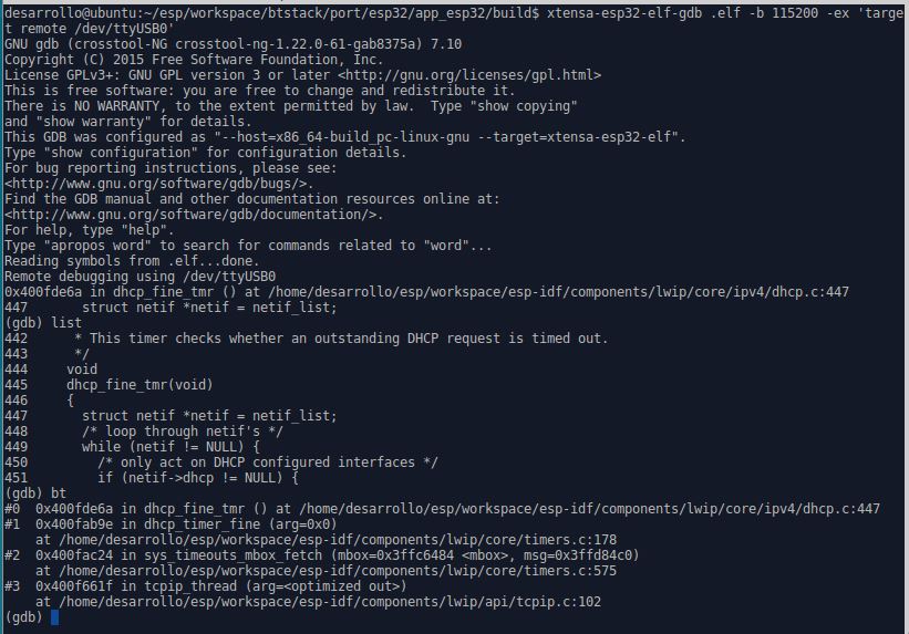

We tested it again and now you have also the error shown in bt.c, here you have the crash and dump info. We really appreciate your help.
Case 1

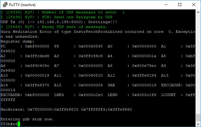

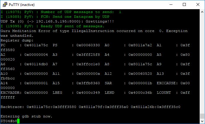

Postby kalimanmer » Wed Sep 27, 2017 3:00 pm
Case 2

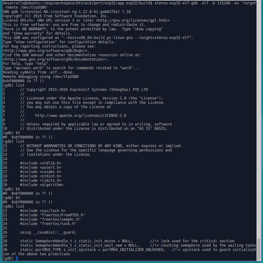

Postby kalimanmer » Wed Sep 27, 2017 3:01 pm
Case 3 and last one
