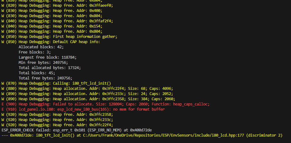

The results I got back were interesting, here's the monitor console output:
So indeed, the function is asking for a lot of memory, more than what's available in a single block.
My questions are:
1- Is this total free memory amount normal? 249756 bytes is less than the half of the 520kb available. I'm fairly new to ESP32, and I honestly couldn't find information about it.
My chip information:
Chip is ESP32-D0WD-V3 (revision v3.1)
Crystal is 40MHz
I was also worried it might have been fragmentation, but the largest block available have 118784.
2- Is this library behavior normal? Or it's something I'm doing wrong that's causing it to request an enormous (128004B) amount of memory?

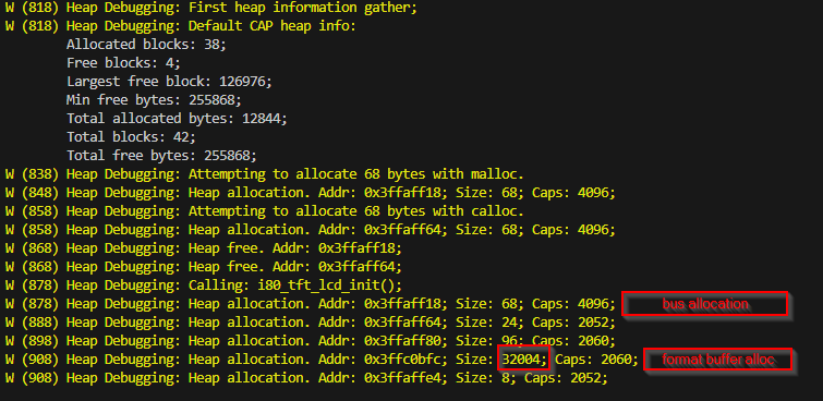

*EDIT* I tried allocating memory myself with both 'heap_caps_malloc' and 'heap_caps_calloc' and everything worked out:
// Random allocation test.
ESP_LOGW(HEAP_DEBUG_TAG, "Attempting to allocate 68 bytes with malloc.");
void* test_buffer1 = heap_caps_malloc(68, MALLOC_CAP_DEFAULT);
ESP_LOGW(HEAP_DEBUG_TAG, "Attempting to allocate 68 bytes with calloc.");
void* test_buffer2 = heap_caps_calloc(1, 68, MALLOC_CAP_DEFAULT);
heap_caps_free(test_buffer1);
heap_caps_free(test_buffer2);
I'll post the code I took from the example, I'm probably doing something wrong.

Alright I've figured out. Will post the findings here if someone has the same problem.
Firstly I was wrong. The allocation attempt causing the problem wasn't the one allocating for the bus handle, but the one allocating for the format buffer. Here's the call:
#if SOC_I2S_TRANS_SIZE_ALIGN_WORD
    // transform format for LCD commands, parameters and color data, so we need a big buffer
    bus->format_buffer = heap_caps_calloc(1, max_transfer_bytes, MALLOC_CAP_INTERNAL | MALLOC_CAP_8BIT | MALLOC_CAP_DMA);
#else
As we can see it's trying to allocate 'max_transfer_bytes'. If we check the code above we can find where it works with this value:
size_t max_transfer_bytes = (bus_config->max_transfer_bytes + 3) & ~0x03; // align up to 4 bytes
    // double the size of the internal DMA buffer if bus_width is 8,
    // because one I2S FIFO (4 bytes) will only contain two bytes of valid data
    max_transfer_bytes = max_transfer_bytes * 16 / bus_config->bus_width + 4;
#endif
So it gets the max transfer bytes from the config we passed to it, aligns to 4 bytes and then determines the transfer block size by relating it to the bus width. This buffer size is the size of a single transaction.
Now looking into the example from the ESP-IDF repo, the max transfer bytes passed is calculated as follows:
.max_transfer_bytes = EXAMPLE_LCD_H_RES * 100 * sizeof(uint16_t)
In my case my display horizontal resolution is 320 pixels.
320 * 100 * 2(size of uint16>t) = 64000.
We don't need to worry about the 4-byte alignment because this value is already aligned.
Now calculating the format buffer size.
On the example the bus width is set to 8.
64000 * 16 / 8 + 4 = 128004.
And look at that, the exact value was being requested.
So to work with more manageable buffer sizes we have to either increase the bus_width, decrease the max_transfer_bytes or both.
According to the documentation the bus width can be either 8 or 16 bits, so we choose 16.
The example they transfer 100 lines of pixels at most per transaction. Let's choose something more manageable, like 50 lines.
with the new values we have:
config.bus_width = 16
config.max_transfer_bytes = 32000
Applying the calculations (again we don't need to worry about the alignment because 32000 is already aligned):
32000 * 16 / 16 + 4 = 32004 (~31.25Kb)
Now that's a way more manageable buffer size.
Changing these values and compiling the program again we have success:
And that's it! It's way better to figure out you configure something wrong than finding out the API is broken :D
