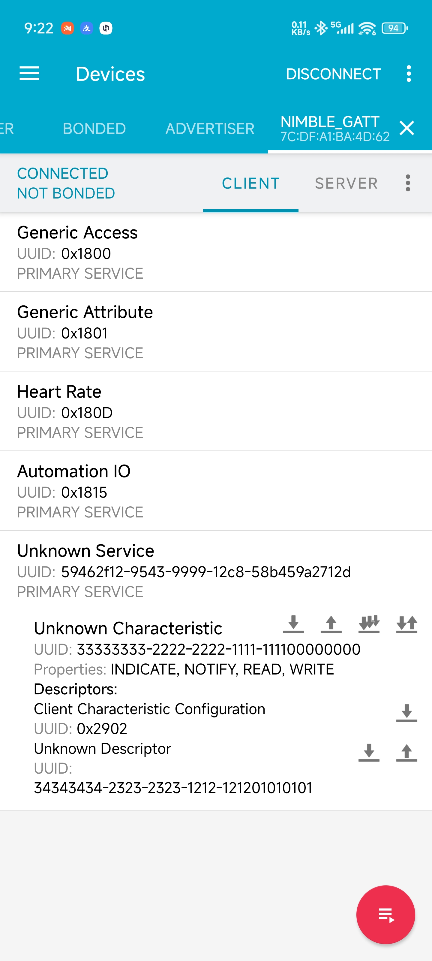

hi there:
I use example project NimBLE_GATT_Server in ESPIDF V5.4.0, and i add some code in this example try to describe an attribute, but it's failure. The phenomenon is as follows: i use Nrf Connect android application to connect to the ESP32-C3 board, when i click the Descriptor read button, app shows: Error 2(0x2):GATT READ NOT PERMIT, How can I solve this problem?
Code as follows:

Pictures: (i delete the Heart rate service and Automation IO service in the above code)

.att_flags = BLE_GATT_CHR_F_READ
This is incorrect in descriptor.
Plesae instead use .att_flags = BLE_ATT_F_READ , and try
