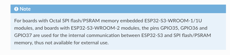

Hellooo
I am trying to flash the SDMMC example from the IDF github: https://github.com/espressif/esp-idf/tr ... card/sdmmc. I have three boards:
1) a ESP32S3-WROOM-1
2) a ESP32S3-WROOM-2
3) a ESP32S3-WROOM-1 N16R8
I am in 1-bit mode with CMD(pin 35), CLK(pin 2), D0(pin 37) on all boards.
The example flashes fine for the first board.
The example gives me these logs infinitely repeating for the second board:

W (260) spi_flash: Octal flash chip is using but dio mode is selected, will automatically switch to Octal mode
I (270) spi_flash: detected chip: mxic (opi)
I (274) spi_flash: flash io: opi_str
W (277) spi_flash: Detected size(32768k) larger than the size in the binary image header(2048k). Using the size in the binary image header.

I (322) gpio: GPIO[2]| InputEn: 0| OutputEn: 0| OpenDrain: 0| Pullup: 1| Pulldown: 0| Intr:0

For the ESP32-S3 WROOM-2 board, based on the initial logs, it appears that Octal Flash mode is enabled. According to the documentation https://docs.espressif.com/projects/esp ... components, GPIO35, 36, and 37 are used internally for SPI flash communication. Therefore, these pins cannot be used for SD card communication.
Screenshot 2025-07-07 at 10.27.02.png (37.83 KiB) Viewed 198 times
Thanks! The WROOM-2 board works now, but I'm having the same problem with the third board.
