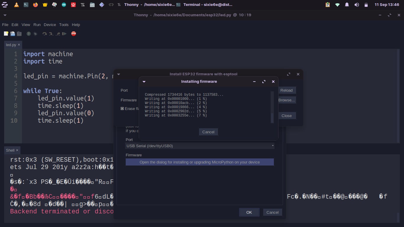

I cannot get it into download mode. I have tried different cables, different computers, CLI, Thonny, ArduinoIDE, different combinations and timing of BOOT, EN, and powering on. I have tried adding capacitors to EN and GND and 3v3/VIN and GND. Different baud rates result in different invalid head of packet addresses. I'm thinking I have a faulty board. I would like to still be able to use it somehow.

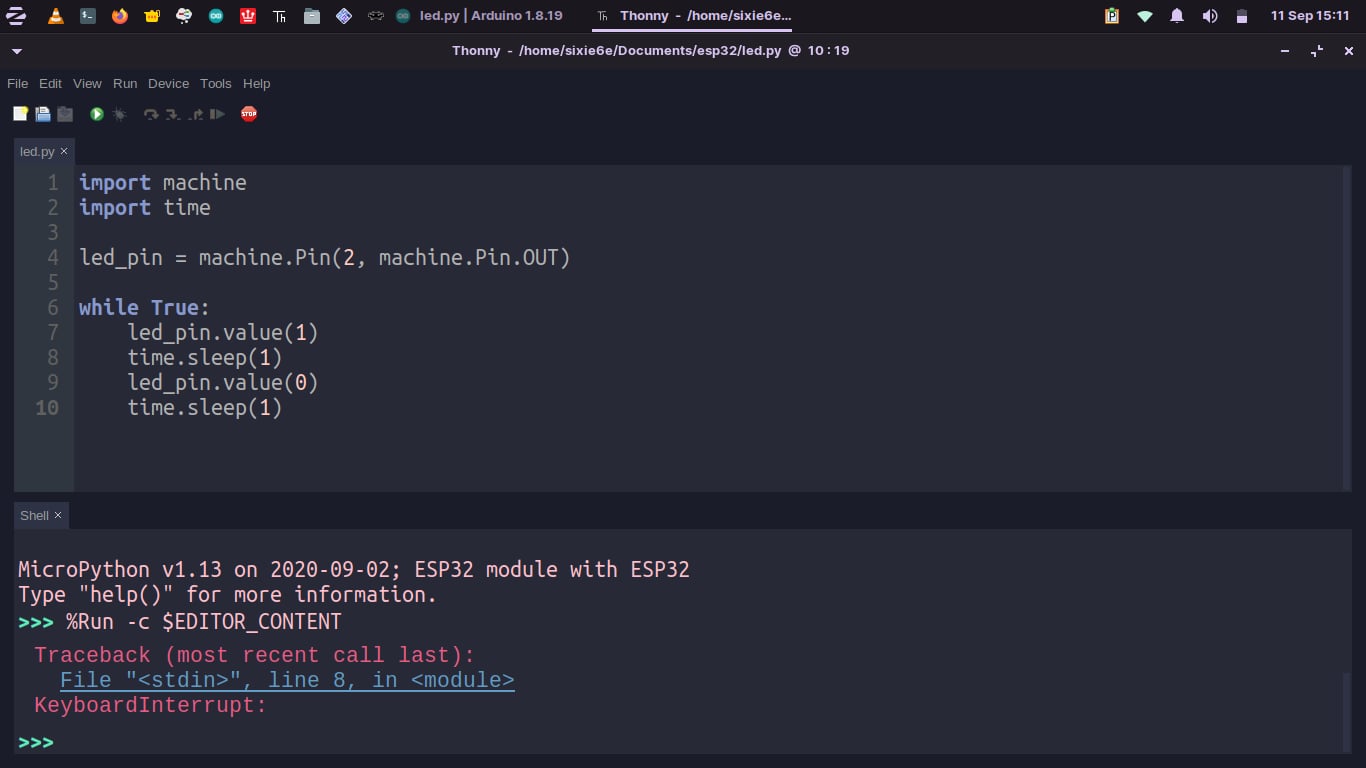

Okay, so what I did was place that 10mf cap, not directly from EN to GND, but to the negative rail of the breadboard. From their site, I chose an earlier version of the .bin for ESP32. Then in Thonny, I chose MicroPython(generic) instead of MicroPython(ESP32).
The board is not lost!

Serial monitor:
configsip: 0, SPIWP:0xee
mode:DIO, clock div:2
load:0x3fff0018,len:4
load:0x3fff001c,len:5148
load:0x40078000,len:12880
load:0x40080400,len:3484
entry 0x40080630
I (539) cpu_start: Pro cpu up.
I (539) cpu_start: Application information:
I (539) cpu_start: Compile time: Sep 2 2020 03:04:09
I (543) cpu_start: ELF file SHA256: 0000000000000000...
I (549) cpu_start: ESP-IDF: v4.0.1
I (554) cpu_start: Starting app cpu, entry point is 0x40082830
I (0) cpu_start: App cpu up.
I (564) heap_init: Initializing. RAM available for dynamic allocation:
I (571) heap_init: At 3FFAFF10 len 000000F0 (0 KiB): DRAM
I (577) heap_init: At 3FFB6388 len 00001C78 (7 KiB): DRAM
I (583) heap_init: At 3FFB9A20 len 00004108 (16 KiB): DRAM
I (589) heap_init: At 3FFBDB5C len 00000004 (0 KiB): DRAM
I (595) heap_init: At 3FFCAD78 len 00015288 (84 KiB): DRAM
I (601) heap_init: At 3FFE0440 len 00003AE0 (14 KiB): D/IRAM
I (608) heap_init: At 3FFE4350 len 0001BCB0 (111 KiB): D/IRAM
I (614) heap_init: At 4009E9D8 len 00001628 (5 KiB): IRAM
I (620) cpu_start: Pro cpu start user code
I (639) spi_flash: detected chip: generic
I (639) spi_flash: flash io: dio
I (640) cpu_start: Starting scheduler on PRO CPU.
MicroPython v1.13 on 2020-09-02; ESP32 module with ESP32
Type "help()" for more information.
entry 0x40080630
