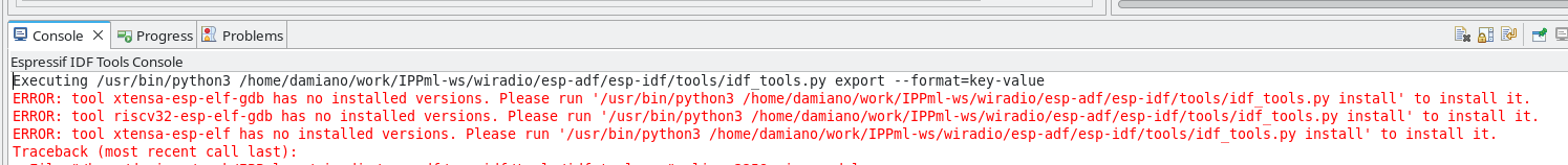

wonderful, the eclipse plugin has screwed even the working environment
this is what I get when I try to clean up the project
NOTE that it used to work, before attempting to use the eclipse plugin
in some way, somewhere the location of the tools is redefined
looking around for alternatives
$ esp-dev
esp-dev is used when you wish to use the shell to compile
esp-env just defines the basic IDF PATH vars
ADF_PATH: /home/damiano/work/IPPml-ws/wiradio/esp-adf
IDF_PATH: /home/damiano/work/IPPml-ws/wiradio/esp-idf
Checking "python3" ...
Python 3.11.2
"python3" has been detected
ERROR: ESP-IDF Python virtual environment "/home/damiano/.espressif/python_env/idf5.4_py3.11_env/bin/python" not found. Please run the install script to set it up before proceeding.
Python 3.11.2
File "/home/damiano/work/IPPml-ws/wiradio/esp-adf/tools/adf_install_patches.py", line 19, in <module>
from idf_py_actions.tools import idf_version
File "/home/damiano/work/IPPml-ws/wiradio/esp-idf/tools/idf_py_actions/tools.py", line 25, in <module>
from esp_idf_monitor import get_ansi_converter
ModuleNotFoundError: No module named 'esp_idf_monitor'

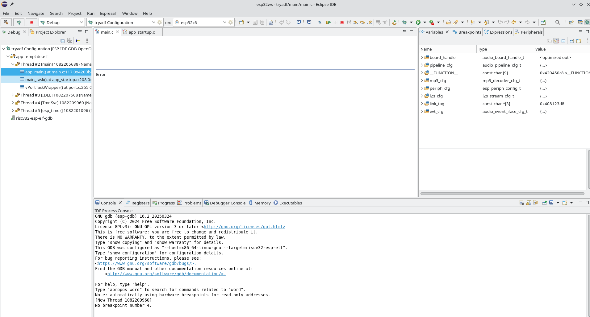

Tried the new ESP-IDF plugin beta for Eclipse, cannot set where the tools directory is, simply there is no choice
https://dl.espressif.com/dl/idf-eclipse ... ates/beta/
Can anybody send a message to developers "removing features do NOT make people satisfied"
so, went back to trying to get Eclipse CDT 2025-09 to work with the latest official ESP-IDF plugin
https://dl.espressif.com/dl/idf-eclipse ... tes/latest
One of the BIG issues is that it appears that tools are part of IDF, but they are not really, they have a life of their own
Since tools are on their own, make it clear, allow users to install them like ESP-TOOLS, a simple bash script, you could even use python, please STANDARD python, not a hacked version.
anyway, I have it mostly working, this is the latest error message
NOTE that the code can be compiled and run on the CPU, I do it using idf.py
what does NOT work is the IDE and the debugger
I cannot open a bug into github for IDF plugin since their idiotic double verification had shut me out
It is quite easy to gave GOOD review on github, just shut people out.....
I am really tired
I am really tired
