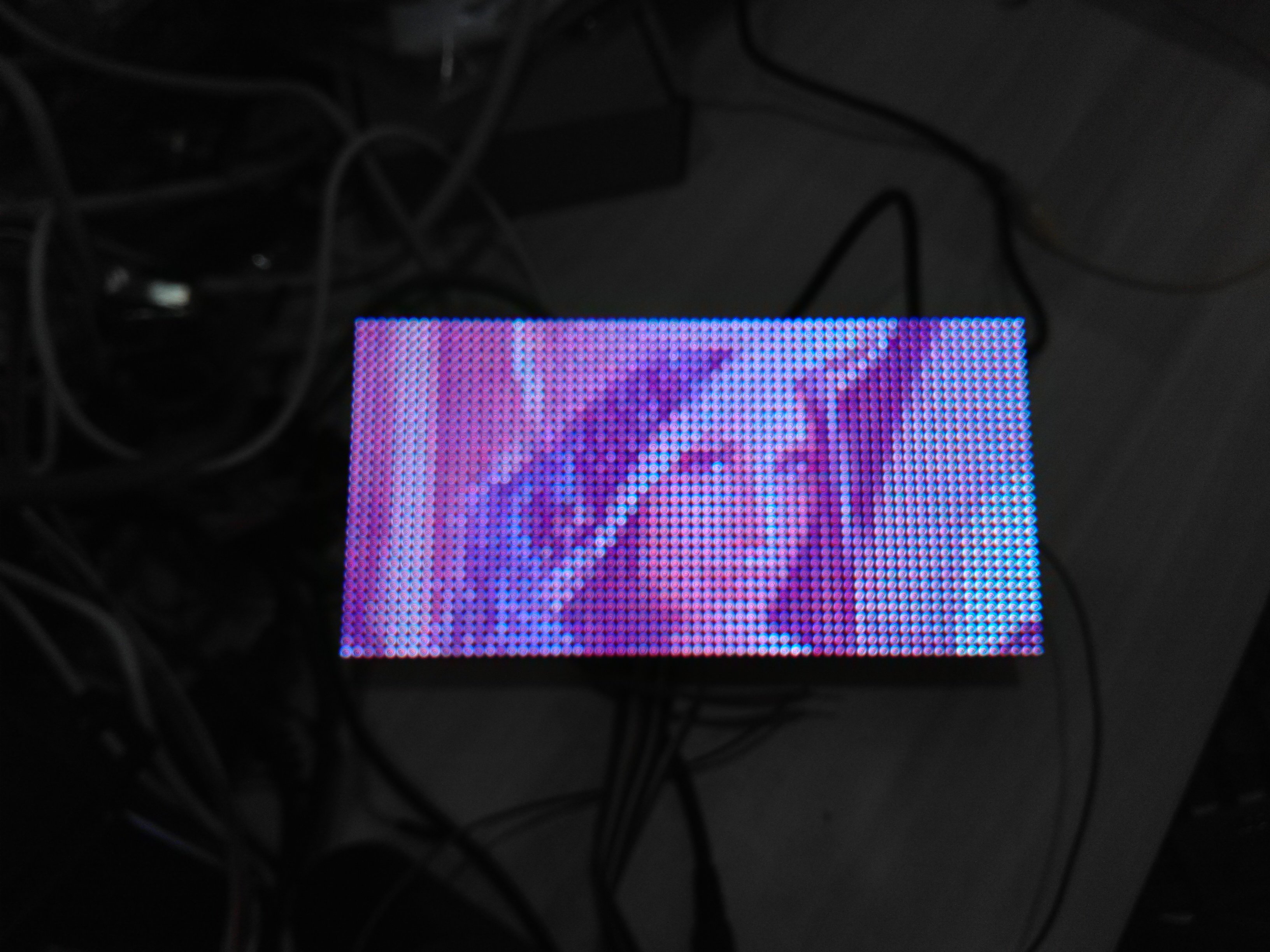

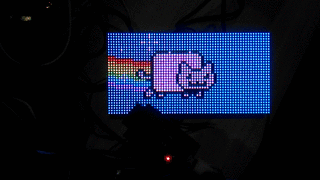

So while we're still working on some kind of official driver for the parallel mode of the I2S peripheral, we do already have some logic for it working. Essentially, we can use DMA to set up a round-robin buffer to output a selected set of buffers over and over again. THis is ideal for generating a fixed signal of some sorts, and can be used to control a 'dumb' LED-display. This is what we did:
The logic involved actually is somewhat more involved than it may look: because the LEDs on the screen can only lit on 2 out of the 16 rows at the time, the display needs to be continuously supplied with data. To complicate things even more, each subpixel can only be turned off or on, so there's no chance of doing grayscale... unless you send a bazillion subframes to get something like PWM working. The end result is that the DMA engine in the ESP32 is put to good use here, continuously pumping about 100MBit of data into the LED-display without using up a single percent of CPU power. The result is pretty good:

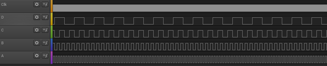

On my display, despite leaving
the display is fine... and looking at the above output, the ABCD lines are in fact being clocked correctly (abcd=0 at the start and by the end of the cycle, abcd=1).
My Lena is more washed out than your picture, but the cat thing looks just fine.
And by the look of it clocking at 4MHz.
My output enable and latch signals appear to be unreliable into by salae logic - probably going to fast for it's 24Mhz capture rate.
However, looking at the ABCD lines it appears each entire frame (64 pixels by 16 (x2) rows) is done in 0.25 ms. Amazing result for zero CPU.

Re: I2S-parallel example: Drive a 64x32 display
Hehe - Lena is weird on LED-screens. Try taking a picture of it or looking at it through your eyelashes - color resolution immediately improves. My guess is that the colors are so similar that the brain focuses on the individual LEDs more than the image.
ABCD control the lines, not the rows
Not sure why your display displays the same.... *cue lightbulb turning on* Aaaaaah wait, I remember that that actually may have been a peculiarity of the I2S hardware: I seem to recall something about it reading 32-bit words and sending the bottom 16-bits first, then the top 16-bits. Gotta look that up next week, but if that's the case, take the comments about the inverted lines with a grain of salt... Ah well, I said it was preliminary, right?
