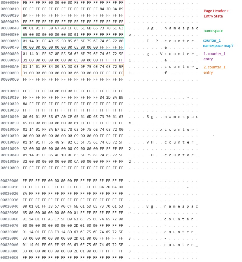

Also reading the flash seems to look good:
virutal NVS partitions.jpg (246.8 KiB) Viewed 1189 times

This hack will work for now. Please be aware of following pitfalls:
  • If you are planning to use wifi, it internally, by default, uses the partition labelled "nvs". It means it will initialise it correctly via esp_partition API. This will interfere with your solution if the partition you are "virtually" further parting was originally labelled "nvs". You may encounter the data being reinitialised / overwritten or other inconsistencies. You can let wifi doesn't use NVS to store calibration and similar data at all using menuconfig option WIFI_NVS_ENABLED.
  • During the future development of NVS, especially the underlying storage media stack, the function
    nvs_flash_init_partition_ptr()
    may become deprecated.
