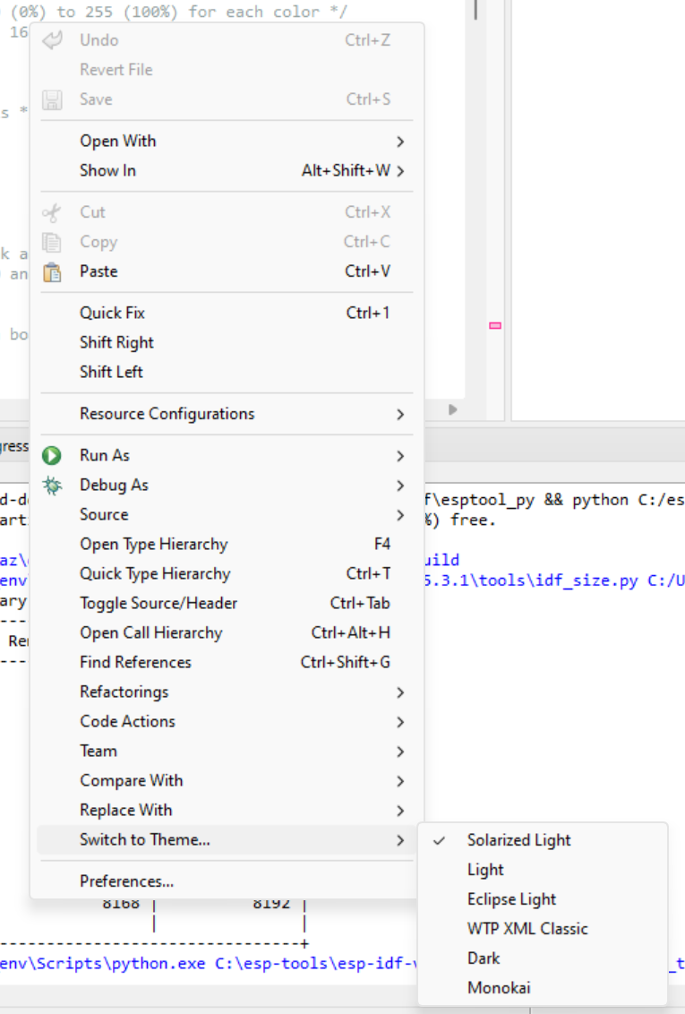

The CDT LSP Editor is based on TextMate in eclipse.
So for now there are a few options for you to configure this and get around the issue of inactive code being highlighted as a comment. The easiest is to just switch the theme.
If you right click on the opened file in the editor you can see this option If you switch to the Light theme you should have a clear difference between the inactive code and the comments.
Also you can choose the Eclipse Light if you want something similar to CDT C/C++ editor.
The other option is that you can create your own css files for syntax highlighting that is a bit tricky but if you look around the TM4E github repo you can find predefined css styles and then you can modify and add them to the TextMate preferences under Themes in Eclipse's Preferences.

Hi Please see the last commentI tried the v3.1.0, but inactive code is still marked as comment instead of just background highlight of whole block while keeping original syntax highlight. Unless I missed some settings?
See https://github.com/clangd/vscode-clangd ... 1502199447 for reference.
viewtopic.php?f=40&t=41302&p=141374#p141374
Re: Very disappointed in the decision to use the C/C++ (LSP) editor
Ok, so you can change its color, but it is still basically "commented out" at it changes color of the text, therefore we loose original syntax highlight of the inactive code.
But I want to keep the original text color, just change the background. And not just background of the text itself, but background of whole inactive block of code.
And judging by the vscode-clangd extension discussions that may not be as simple as it sounds (they basically had to create their own protocol for this feature to work correctly).
