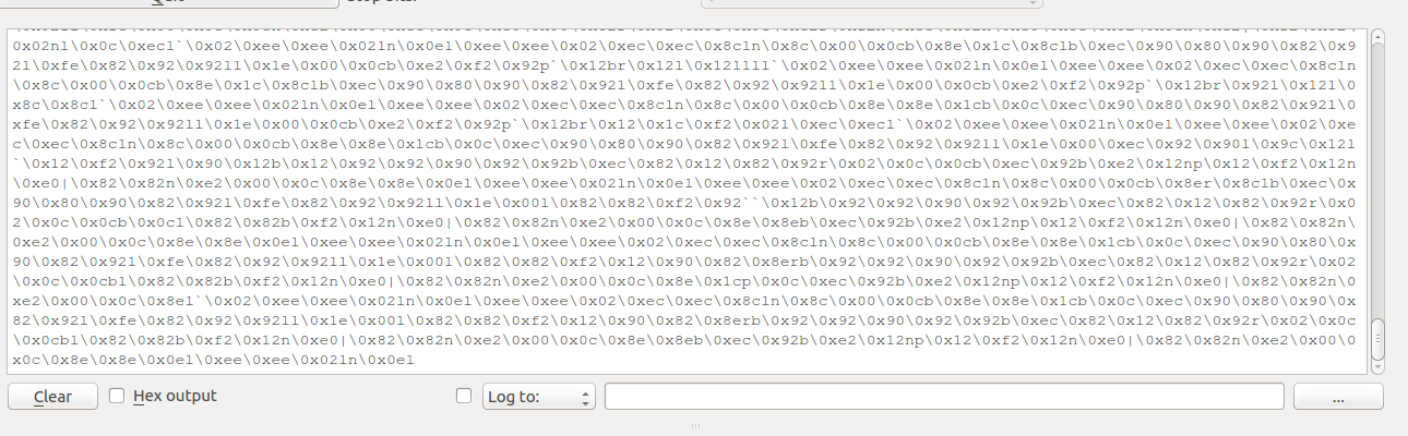

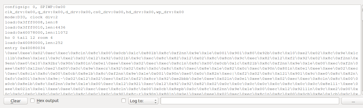

here is the log
The hex output will come for around 30 sec and then nothing happens. I am getting the same result for every example codes.
the current version of xtensa tool-chain i am using is : crosstool-NG crosstool-ng-1.22.0-61-gab8375a
i have also tried :crosstool-NG crosstool-ng-1.22.0-73-ge28a011 , with this one, i am getting a warning message as toolchain is not supported. :roll:
Screenshot from 2017-10-06 20-41-33.png (110.42 KiB) Viewed 9627 times
Screenshot from 2017-10-06 20-40-57.png (85.06 KiB) Viewed 9627 times
