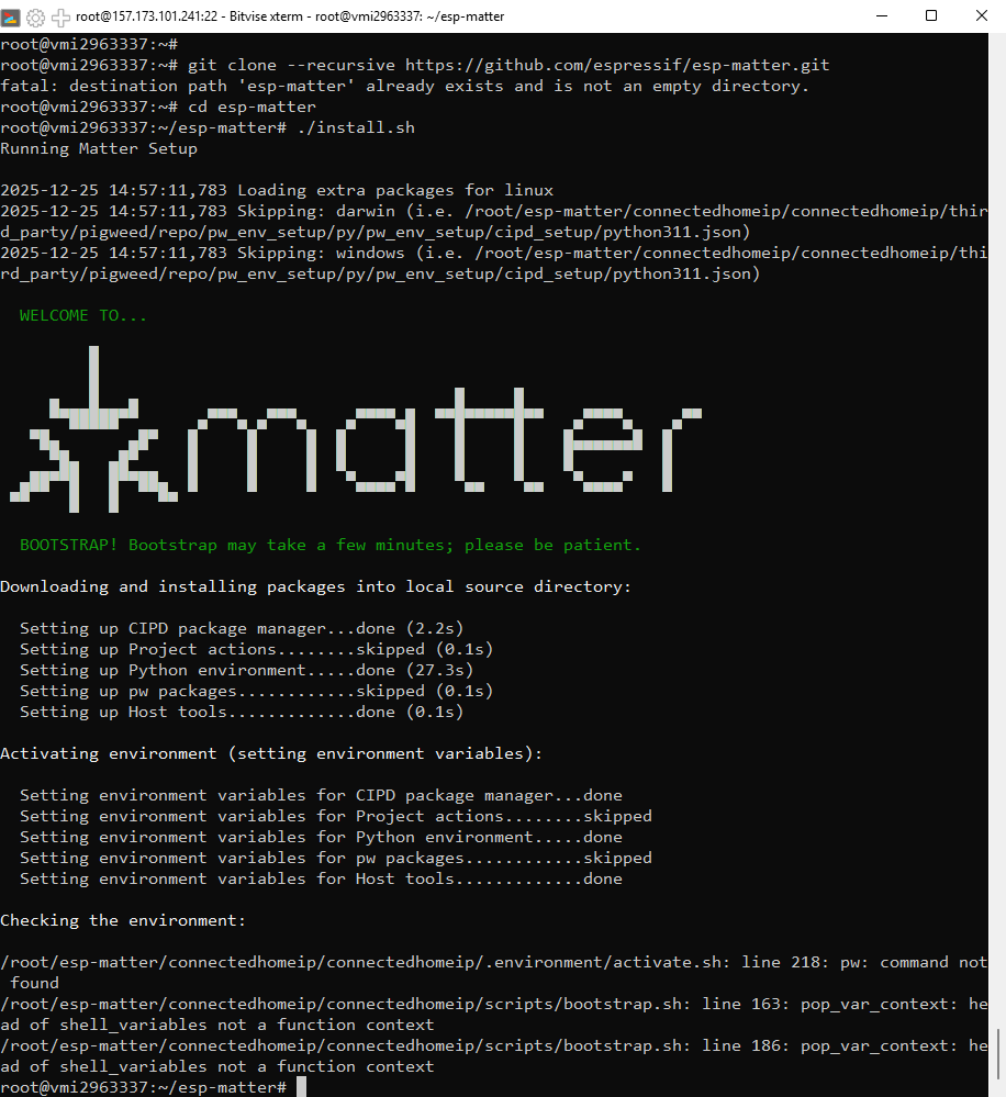

AI is reporting to:
git submodule sync && git submodule update --init
to fix the above fault. Will attempt and update this thread.
Re: Unable to build ESP Matter with ESP-IDF
From here:
https://github.com/espressif/esp-matter/issues/212
Try deleting the esp-matter/connectedhomeip/connectedhomeip/.environment folder manually and try install.sh again. It worked for me.

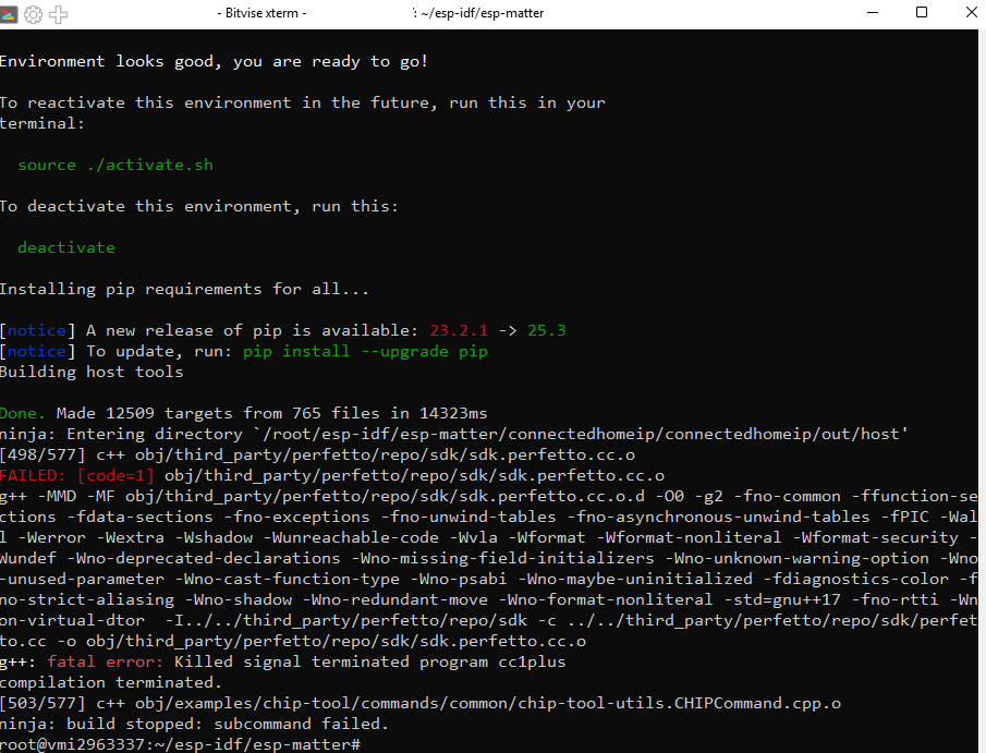

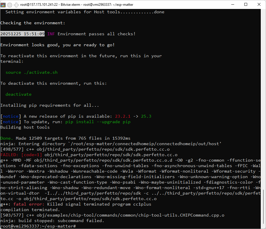

Results in:
From this:
https://stackoverflow.com/questions/669 ... to-install
Do we need to have more ram in our VM?
Results in:
From this:
Can confirm, I have been installing ns3 V3.33 and around [2447/2973] compilation this error came out.
For the solution I doubled the base memory of my VM (2048mb -> 4096mb), then the compilation finished successfully.

The VM cloud server is fine with the selected resources.
Installed the ESP-IDF and the ESP-MATTER toolchain ok.
Attempting to compile for ESP32C5 which is under '--preview' mode. Fine.
