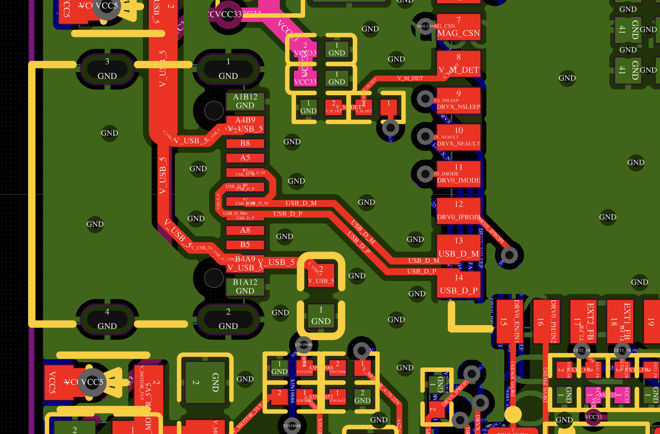

I built up a prototype PCB and I can't seem to get the USB port to communicate. The USB hardware configuration seems easy enough GPIO19 (Pin 13 on ESP32-S3-WROOM-1-N8R2) connects to D- and GPIO20 (Pin 14) connects to D+. Here is a image of the layout:

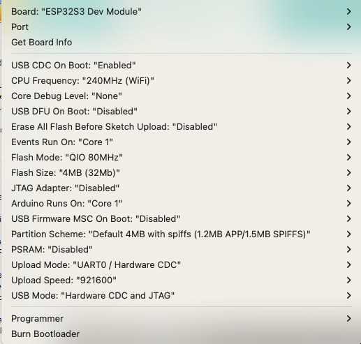

The UART port on pins 36&37 can communicate with the ESP32-S3 without a problem, but I am getting no activity on the USB port. I have tried various configuration setups through the Arduino GUI, but not matter how these are configured the USB port does not enumerate.
Is there an eFuse bit that I am missing to enable the USB Port?
Screenshot 2023-12-13 at 4.35.32 PM.png (114.58 KiB) Viewed 119532 times

Can you try pulling down GPIO0 while resetting (or powering on) the ESP? That should put it in download mode, which prevents any firmware-related issues from stopping USB from working.

Yes, but the board does not enumerate over the USB port under a BOOT power on or a normal power on.

I also scoped the levels of GPIO3, GPIO45, GPIO46 during power on, and these are all LOW. GPIO0 is button controlled.

I got nothing, sorry. You used the correct pins, USB-C pinout matches what I have in a verified-working project, bootup chatter looks correct. Only thing I can imagine is a physical thing, e.g. a badly soldered connection or a short or something, or perhaps an USB-C cable that is charging-only or broken.
Ah, one thing that *may* influence things, but I'm not sure... you don't have 5.1K resistors on the CC pins; I'm not sure if this disables USB communication entirely if you're connecting natively to an USB-C host. You can try to see if the device works with an USB-C-to-USB-A cable; if so, that is your problem.

I'm going through a hub with USB-A connectors so the CC pins and the Superspeed side channel signals do not make it to the host. The cable I've been working with enumerates other USB-C peripheral so I don't think this is it either, but I will test a different cable to rule it out.
Maybe it is a build issue. The second unit I tried also didn't enumerate over USB either, but the LDO got excessively hot when it was plugged in for more than a few minutes. I will finish assembling another pair of units to see if they behave the same.

Im almost certain both cc pin resistors(usually 5.1k in esp case) needs to be there for it to work currently, without those host device cant negotiate power or know cable orientation.
You need those resistors(one resistor per cc pin to gnd, cant be tied together) even on a usb-a to usb-c cable if im mistaken.
