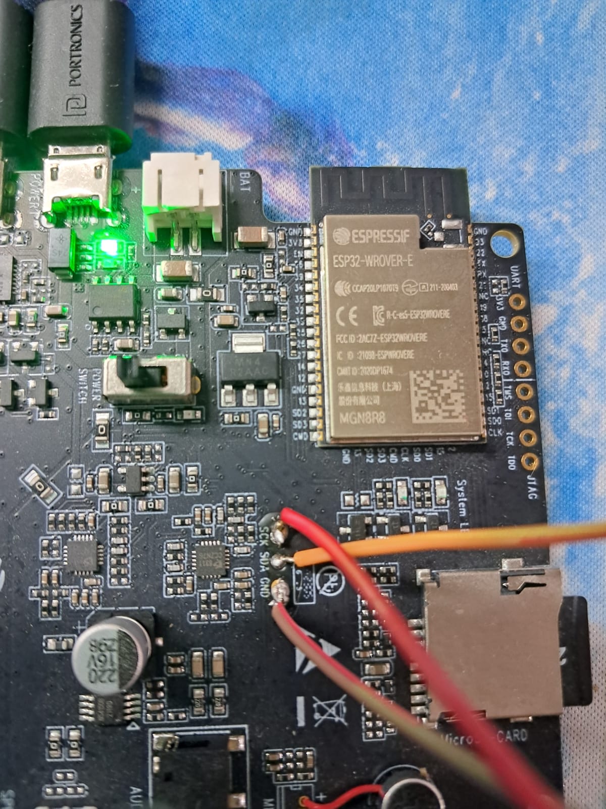

Those things are NC in the sense that they aren't connected inside the module, as they're used for PSRAM. I think the Lyra-Mini has test points for the internal I2C bus (labeled SCL/SDA/GND), perhaps you can hook the MCP up to that?
Re: How to connect mcp23017 with lyraT mini v1.2 board
Thank you for your valuable reply. I see that above the audio coded there are 3 gold circles - SCK, SDA and GNDThose things are NC in the sense that they aren't connected inside the module, as they're used for PSRAM. I think the Lyra-Mini has test points for the internal I2C bus (labeled SCL/SDA/GND), perhaps you can hook the MCP up to that?
I don't see SCL, are they both same?

Those test points in the middle are going to the I2C bus that runs the ADC and CODEC, not I2S. ChatGPT does not know how to read a schematic...
An alternative would be to set up a new I2C bus using pins 12 and 13 (TDI & TCK), which appear to be unused if you aren't running jtag.

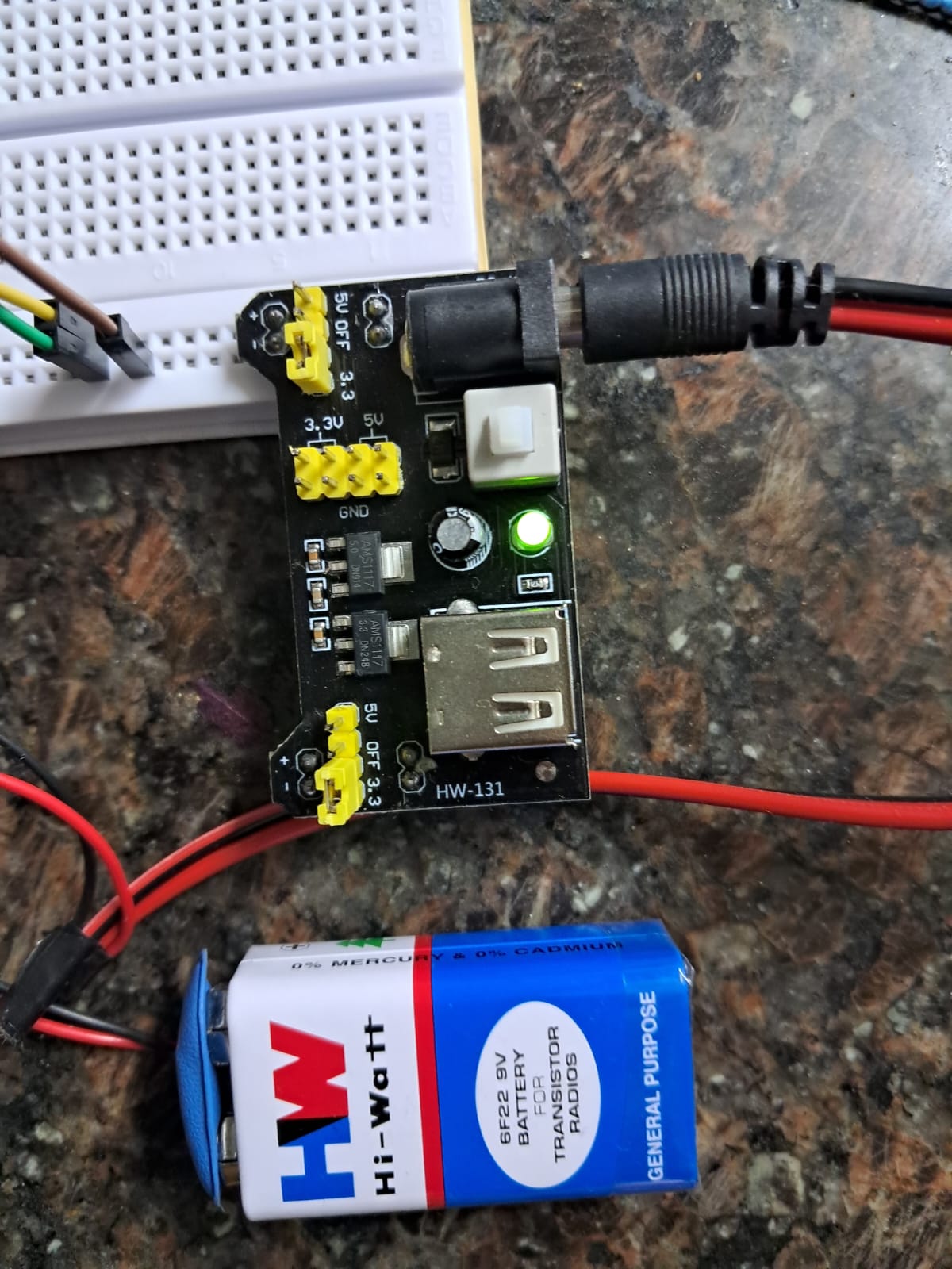

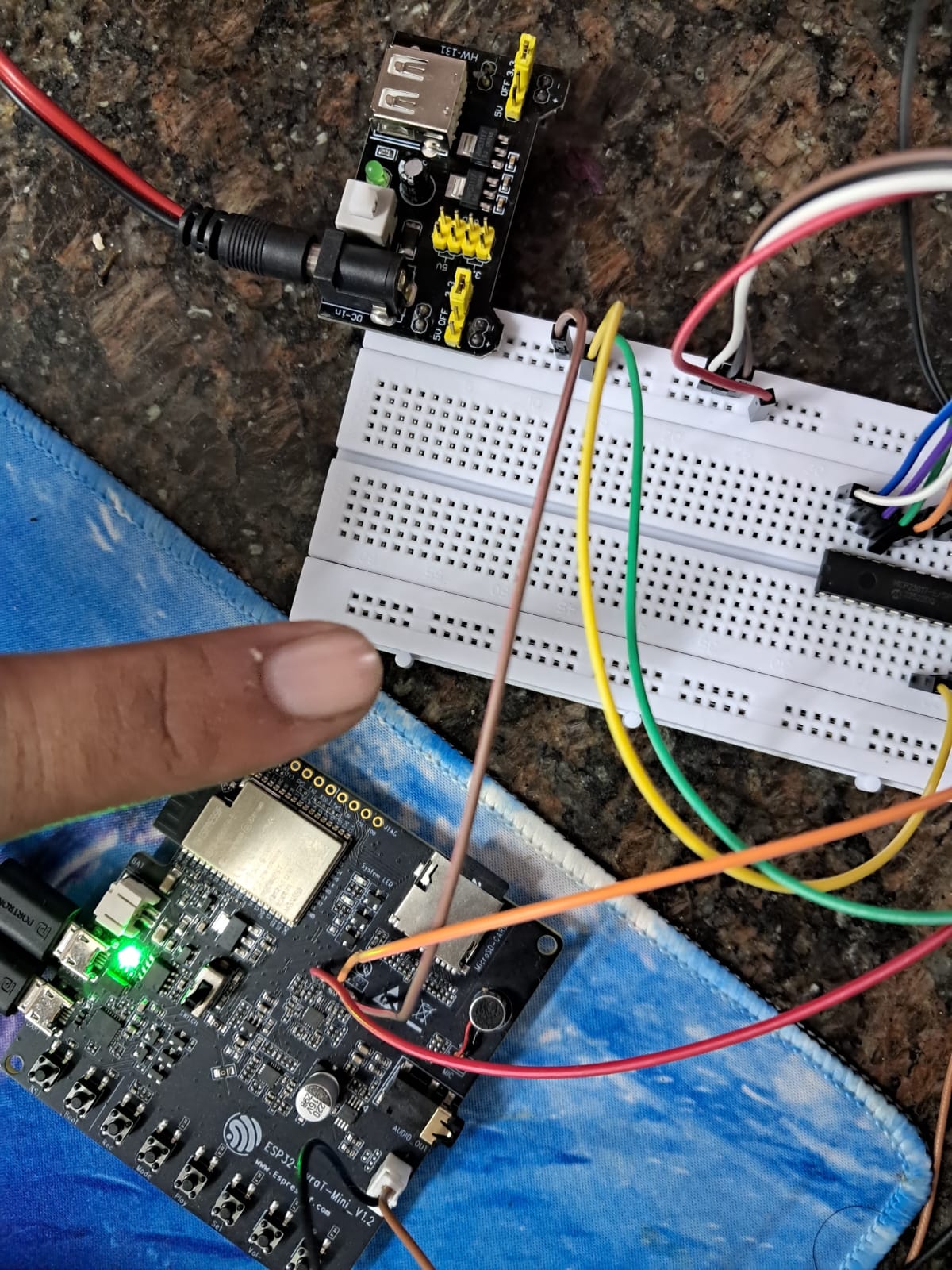

I managed to solder the 3 gold pads on my LyraT Mini v1.2 board. With a multi meter I confirmed that the pins are not shorted.
I have a breadboard that is supplied with 3.3V via another IC HW-131. I connected the ground from GND I2C and GND from battery as a common ground in the breadboard.
The breadboard has the MCP23017 IC, GND, SDA and SCK are provided from I2C to the MCP chip.
I wanted to make sure the the SDA / SCL / GND pins are correctly soldered or not. Is there some logic I can ask the AI to write that tells me that the pins are giving the right output. The reason for asking this is because I connected the 4x4 keypad but it is not able to detect the key presses - it thinks that some pins are already pressed. Moreover, this is the first time I soldered, so there is a good chance I would've messed something up.
I am using SD card play sample project and that seems to be working fine, I can hear the audio through the speakers. If I would have messed up the solder, then I wouldn't be able to hear the audio right?
I've attached images

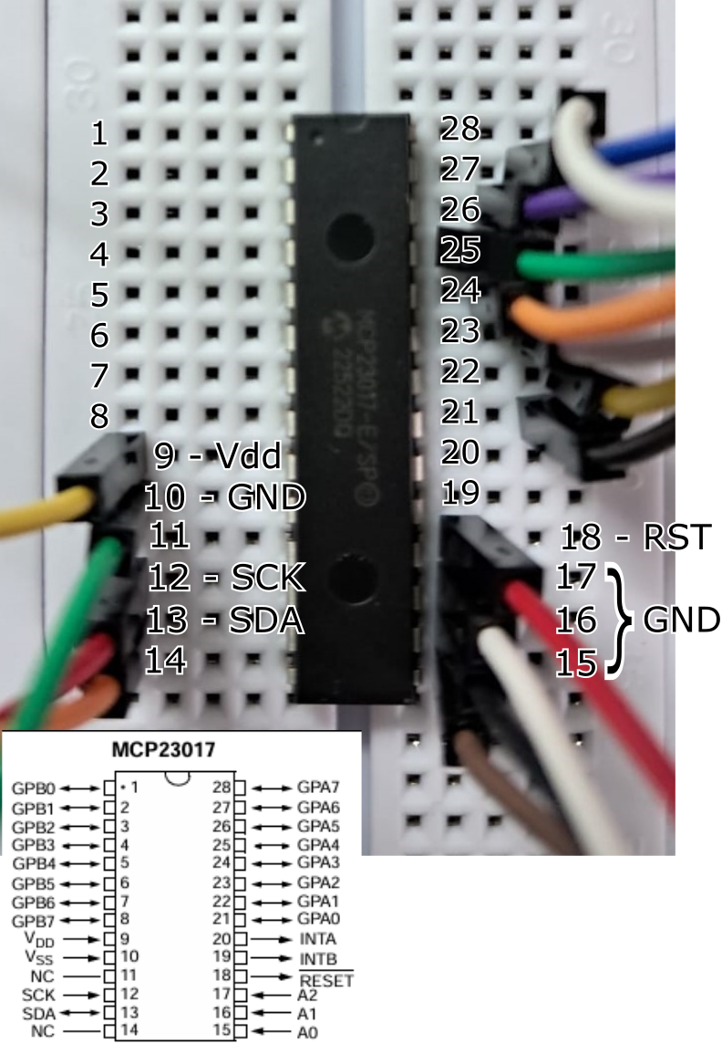

Attaching illustrated pinout for MCP23017

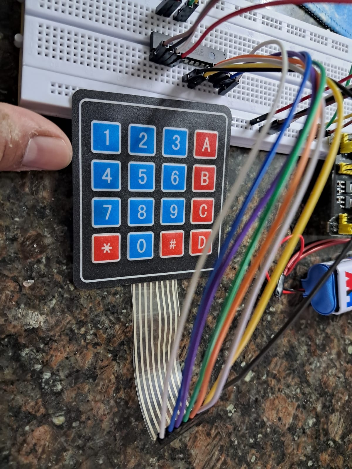

And the keypad

You should be able to run the Wire (aka I2C) scanner and see the device at the correct address on the bus (looks like you have it set to 0x20), along with the other devices connected to the bus (I don't know their addresses offhand). The mcp23107 isn't the most complicated of devices, but you'll still likely want to use a library of some sort (Arduino / ESP-IDF) so that you don't have to write your own decoder.
